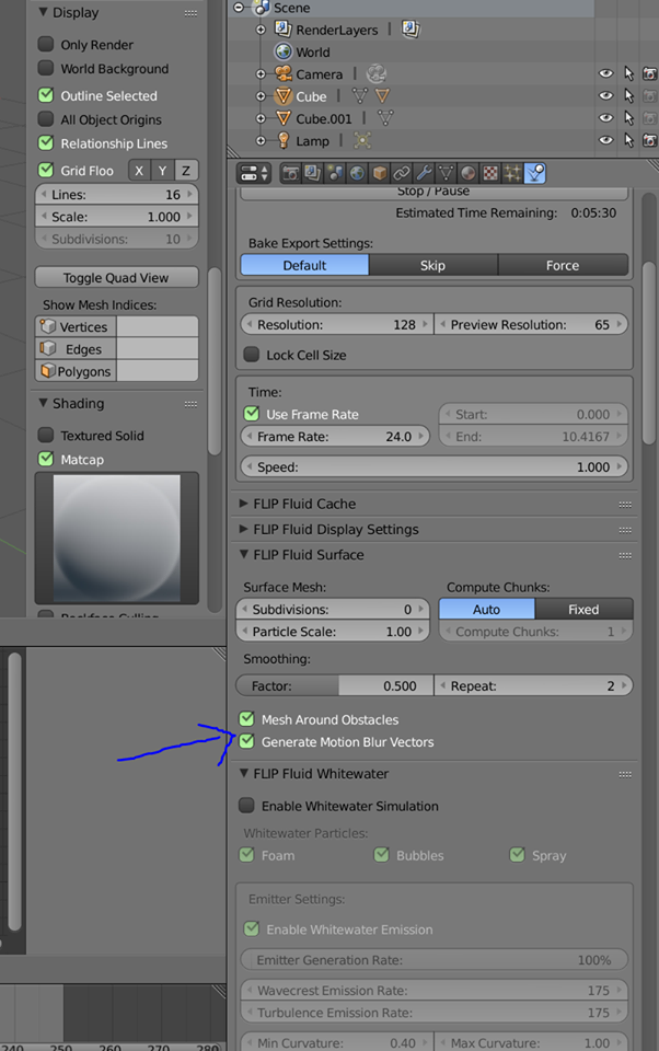

This is what he showed, I don't have Flip Fluids yet and the example is in Octane v4 for blender I believe so I can't verify at the moment.grimm wrote:I would be very interested in that as well, I generated the fluids with Flip Fluids as well, but I couldn't get it to work.

Regarding Motion Blur: The Octane Blender Internal motion blur doesn't work but the Subframe motion blur does (in order for Subframe motion blur to render you still need to enable both Motion Blur and Generate Motion Vectors in the FlipFluid settings.
