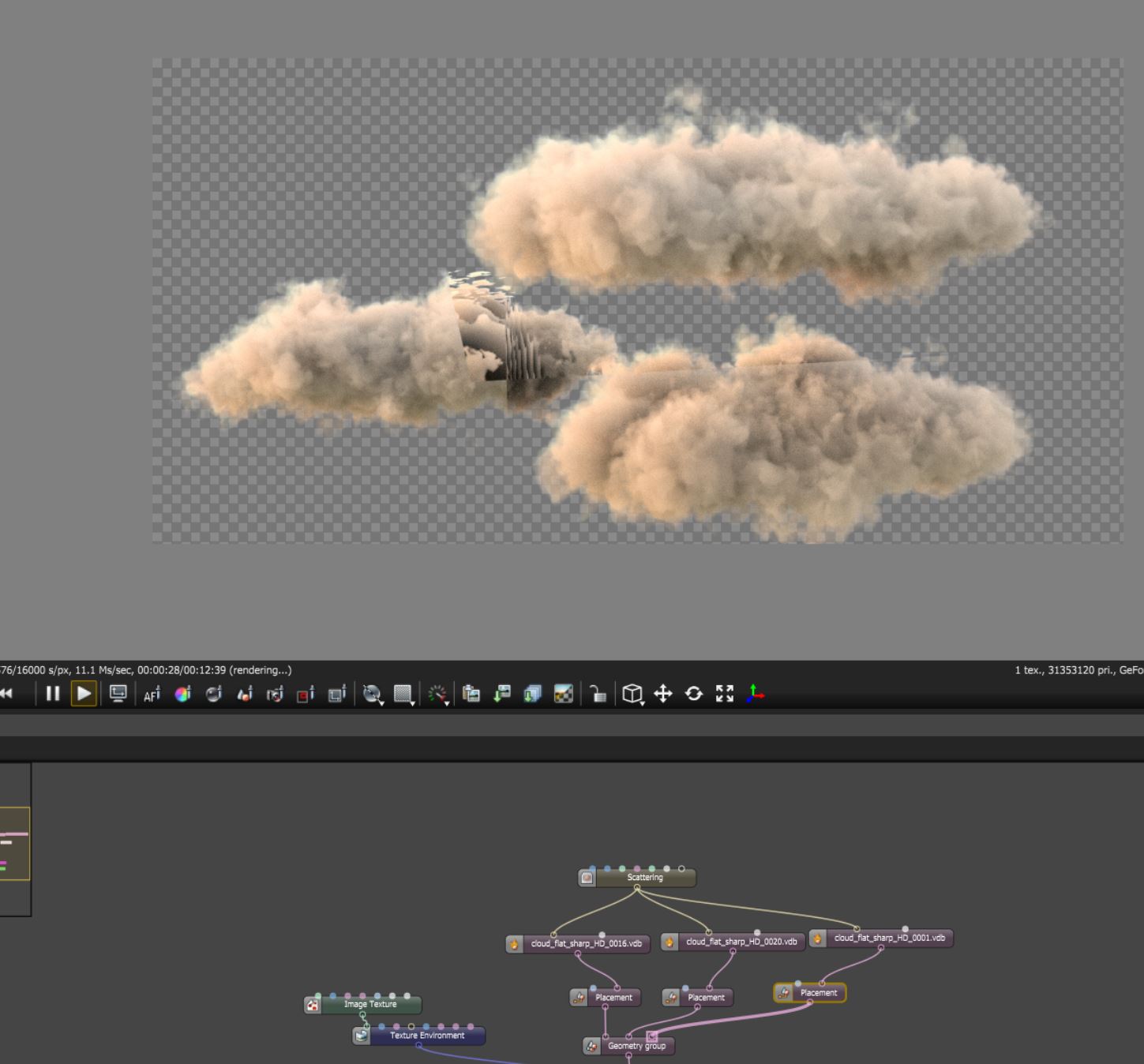

How do I get rid of the bounding box overlap from the VDB clouds I am creating?

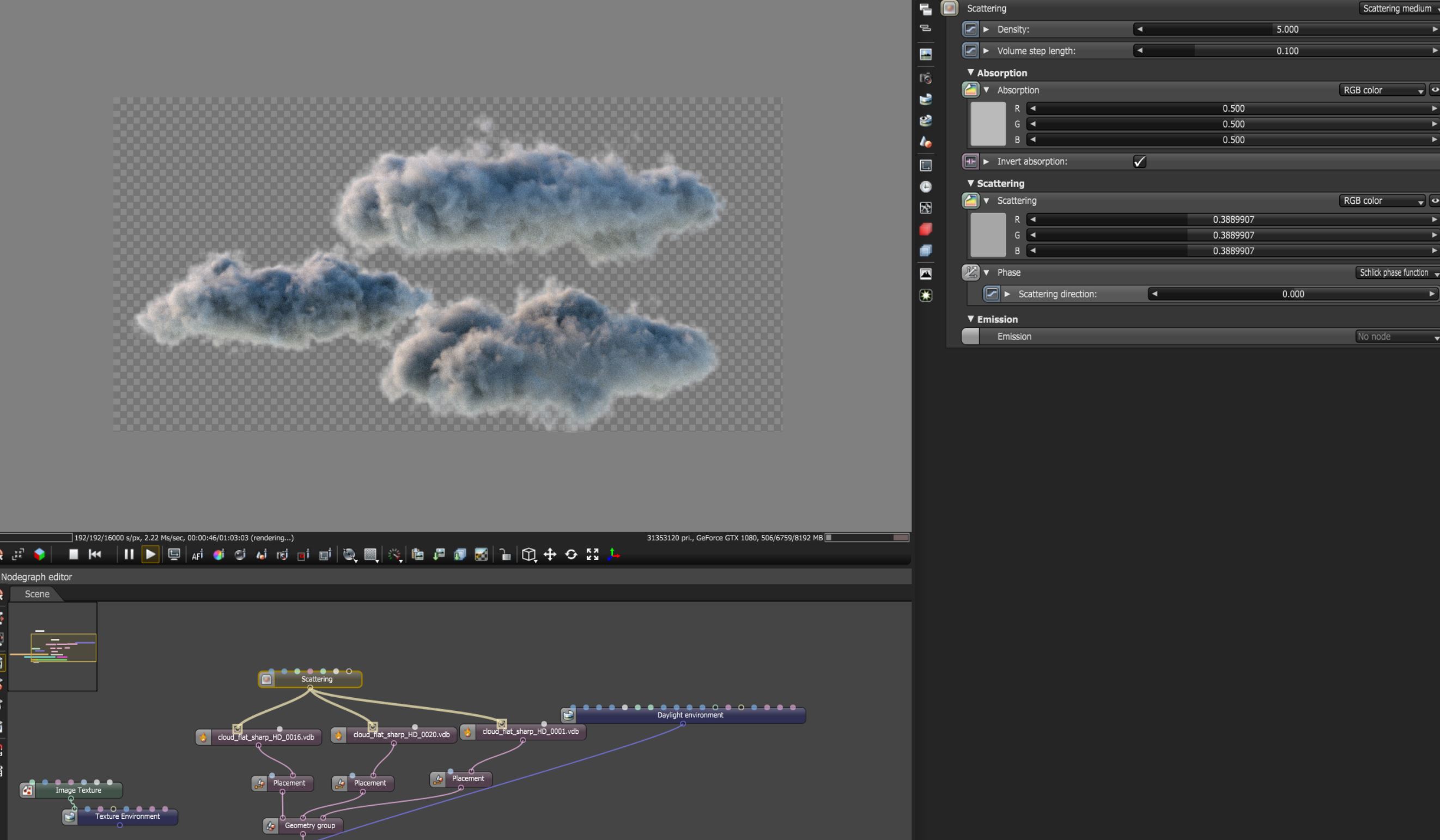

Ah ha step lengths did it
I was in 2019.1 XB2
Changed step lengths (It was 1.6 and I changed it to .1 and density down to 5 and it looks better)

Thanks. A bug just got fixed in this area, with RC1 you should be able to use a larger step length and save some performance (without losing the same look). The issue was specifically when viewing another volume with a section of another volume's bounding box in the way.p3taotoy wrote: Ah ha step lengths did it
