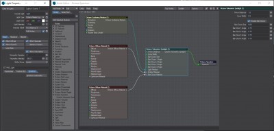

juanjgon
Posts: 8867
Location: Spain
This is the design approach that I have in mind to support the spectron lights in the LightWave plugin. A hard-coded GUI in the Octane light was becoming a nightmare for these kinds of lights due to the large number of parameters available, especially now that we have more spectron light types in the upcoming Octane 2019.2, so I've added a whole new node editor to the Octane light to expose there the spectron light nodes and make possible linking all the additional nodes used by these lights, like the medium or material nodes.
There is a lot of work to do yet, but at least I have the core code designed to try to support this really special and tricky Octane feature inside LightWave.
Thanks,
-Juanjo
