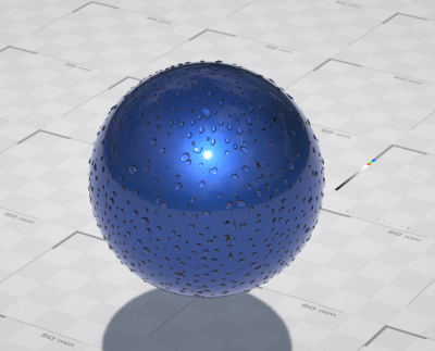

You have several peoblems with Octane here: if you want to stack two materials one base and the second as drops you cannot use displacement becasue stacked mats in Octane C4D cannot apply displacement. I tried it with an opacity channel for the drops but it only worked when duplicating the mesh and slightly scale it. Normally it is recommended to us a Mix mat if you need displacement.
I hope somebody comes up with a better solution. Here the duplicate mesh with opacity:
