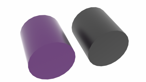

A weird layer related bug. Both meshes have the same material, which uses a material layer. One renders purple while the other is black
NOTE: If I set this up using a layered material, it works OK. I'm using a base material with specular layer plugged into the material layer pin and this seems to be causing the bug.
