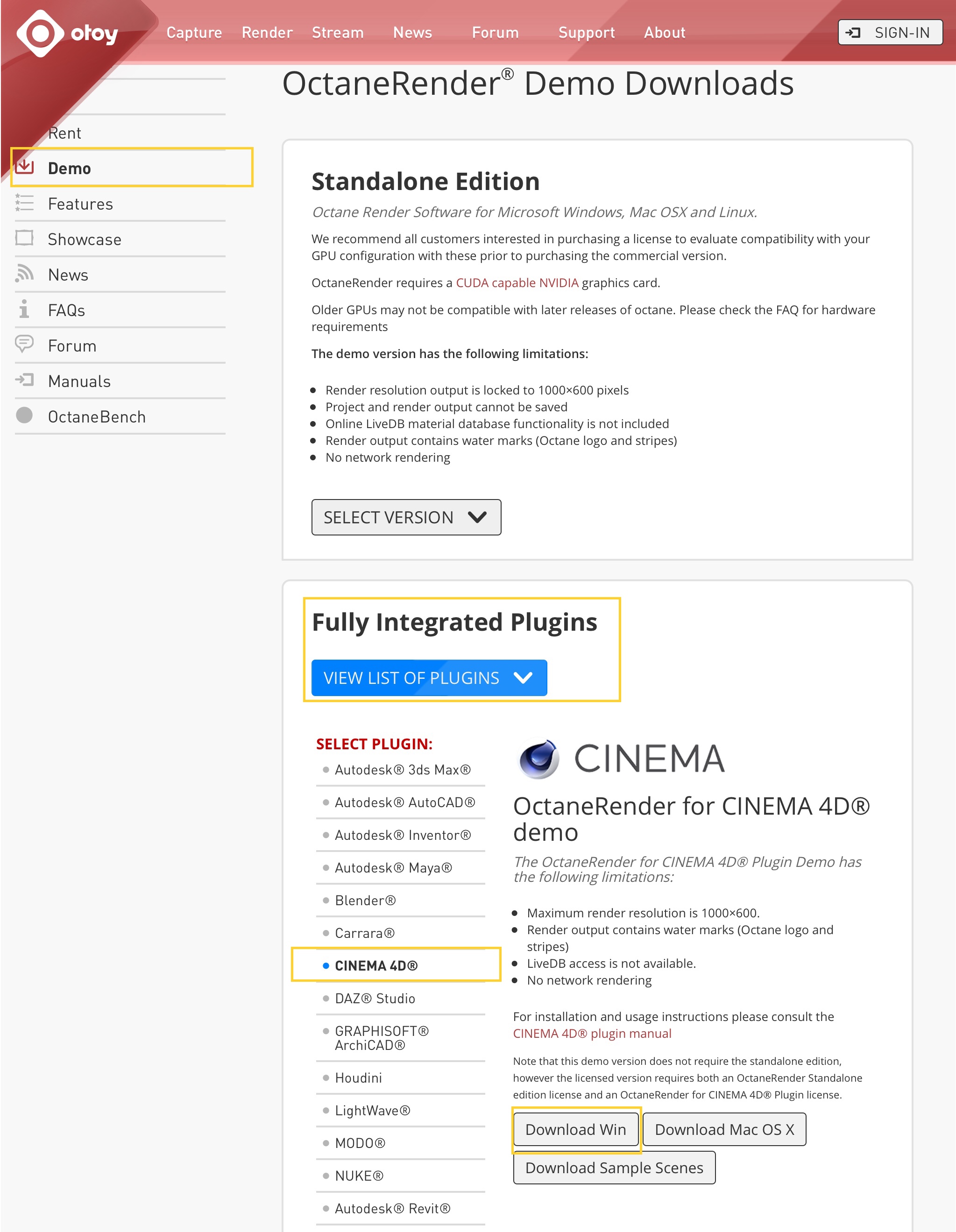

I thought that at least I knew how to install the software properly... Works like a charm! Thank you so much, I guess I can get the full version now since I know everything runs fine. One question though, where can I find the version you provided as in the website I can only download the "C4D-2018_1_1_R2_win" version?
