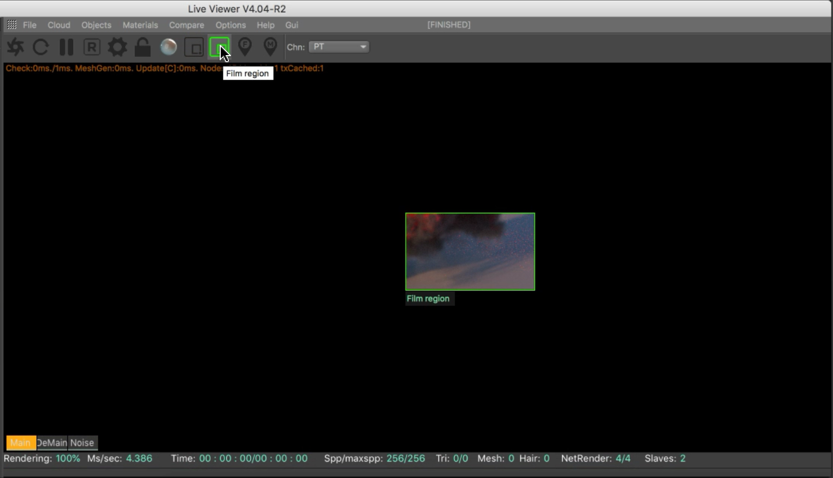

Posts: 10629
There are two options/icons for Render Region.
  • the red Render Region option is designed to refine a portion of a finished render that still has noise in it.
    The max sampling value is not taken into consideration, so the kernel can be stopped when noise has been cleaned up.
  • the green Film Region option is designed to render only a portion of film buffer at Max Sampling value defined in the Kernel settings, with black background.

Thank you very much for the feedback, especially you bepeg4d for the explanation. Now I understand why Render Region does what it does and the Film Region does exactly what I wanted.
It's a bit shame that the Film Region ERASES everything else from the LV so you kinda loose context of other objects in the scene so you either go back to Render Region (because RR keeps the stuff outside the selected area) or sample the whole scene. Either way Film Region is a nice step forward for me! :)
