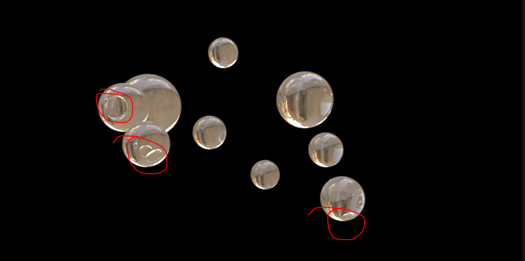

Hi guys,
I need to separate the following pass :
- Scene Object Reflection
- Scene Object Refraction
- Environment Reflection
- Environment Refraction
The goal is to be able to get control over them in compositing, because i need to reduce Object reflection/refraction to 30% but keep 100% of environment reflection/refraction for a retake on a project.
What looks to be a simple problem turn to be a huge chinese puzzle. I have try to play with render passes, object layer map etc ... and i can't solve the problem in an elegant way.
For the moment the best solution i have find is to use object visibility and light linking.
But i need to output 4 additional pass to make it work , and the result is still not perfect.
I would like to know what would be the most elegant way to solve this problem in Octane ?

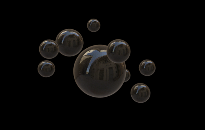

Here are some test image and a simple test project i use.
Thanks for your Lights !
Cheers
E

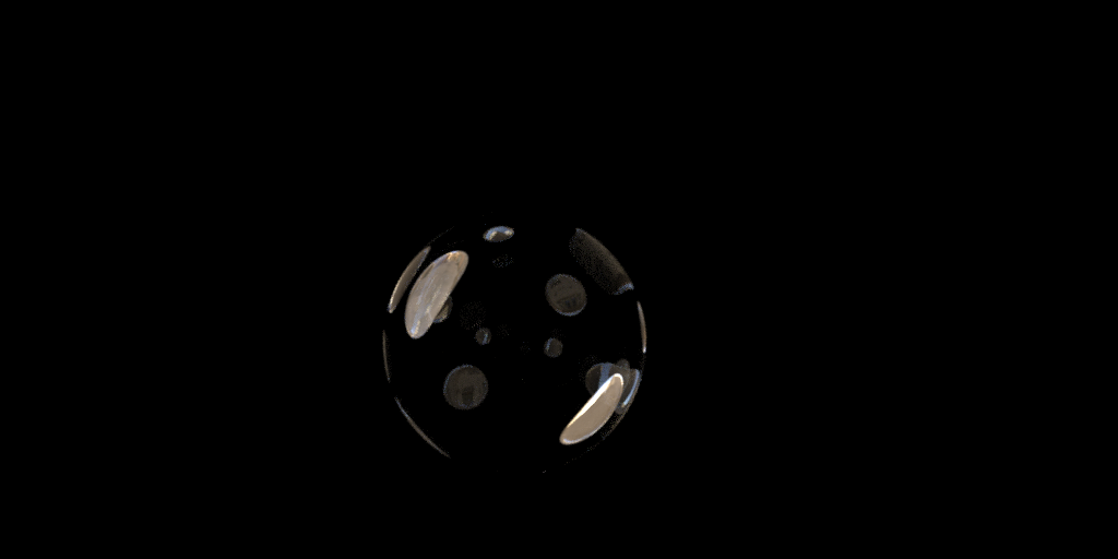

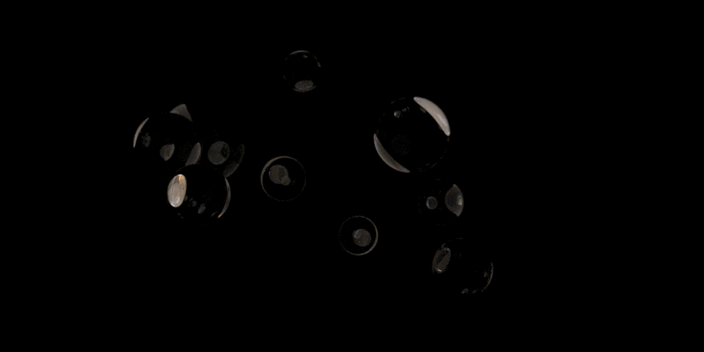

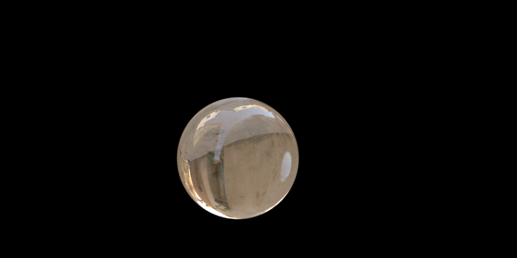

With your tricks i am able to get a clean environment reflection / refraction pass
I have attach the scene
what i can't get is a direct object reflection / refraction pass, cause i can't tell to octane
- compute the object reflection and refraction that need the environment to exist
- but don't add the reflection / refraction created by the environment in the final image

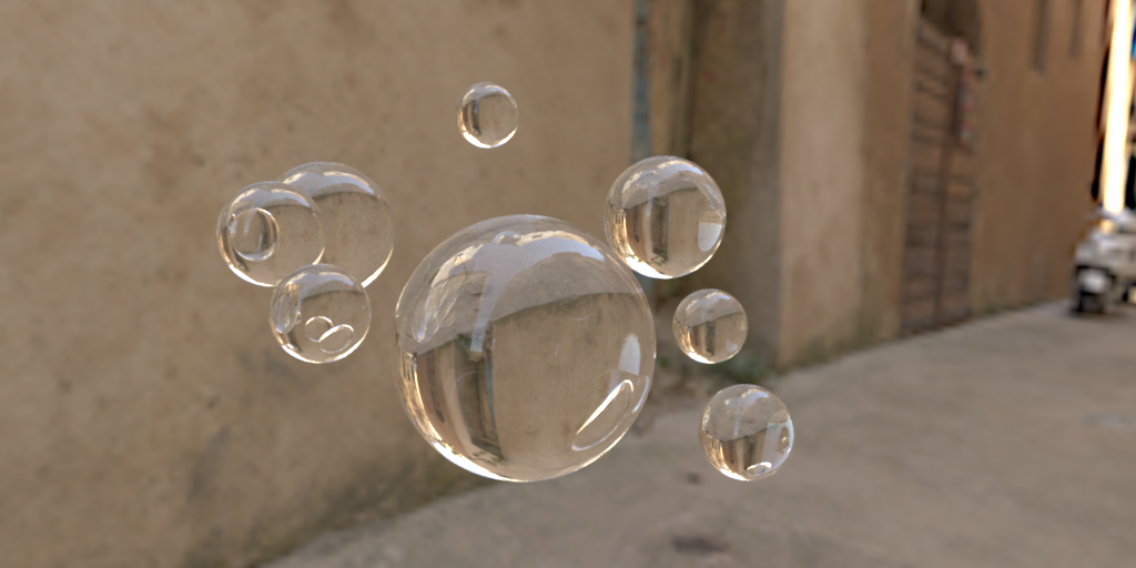

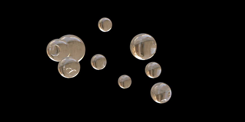

Well i have a good enough solve thanks to your suggestion.
- you need to output reflection / refraction render passes (scene_reflect, scene_refract)
- you need an environment only reflection / refraction render passes with the help of the OSL shader (env_reflect,env_refract)
then you get output = mix( scene_reflect, env_reflect, % ) + mix( scene_refract, env_refract, % ).
EDIT :
unfortunatly this only works for reflection the ray contribution OSL doesn'' t work with refraction, the env map is inverted and at a different location.
