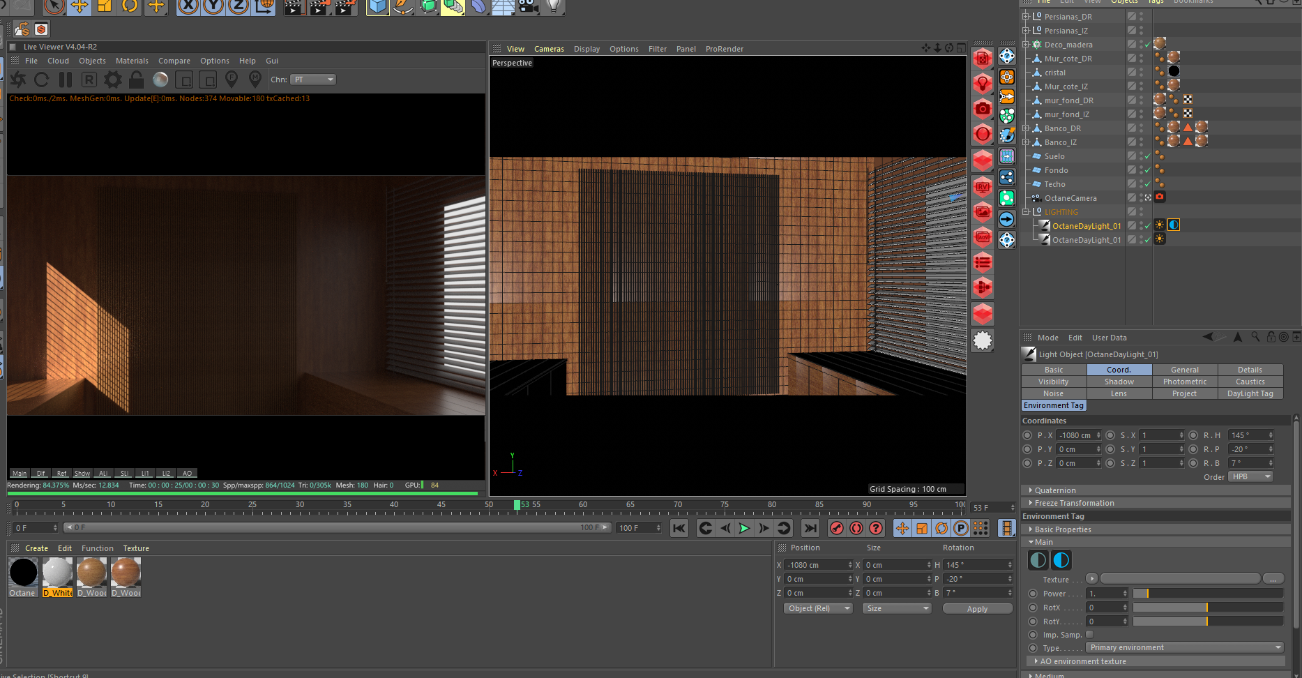

Hi, i'd like to simulate 2 suns illuminationg trought the tow windows.
But when i put the second daylight, it desactives the first one.
How can i simulate that?

At the left of the image, i have the same window like the right and another daylight
The effect is like a miroir effect..

You cannot have two Daylight nodes at the same time, so you need to use the Daylight with an HDRI environment for the second sun, or only one HDRI node and two mixed HDRI with sun.

thanks for your answer, i´m not sure to understand.
I tried with these settings, see below
Why with a aera light, i can't get the same effect on the shadow?

You can get of course if you try enough. Make your arealight far and small enough and set "surface brightness=off"
