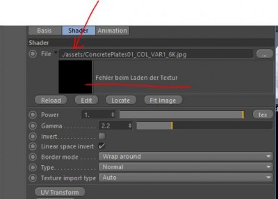

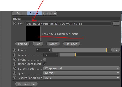

When I download/use a saved Material from LocalDB always the corresponding bitmaps are missing!
Instead, an "asset" folder in "User/AppData/Roaming/Maxon/tex" gets created and the bitmaps are stored in that folder.
But these bitmaps will not load up correctly! In the NodeEditor it says "error loading texture"
(I've set a path to the LocalDB directory in C4D Prefs)
What I`m doing wrong here?

Work on saved scenes as noted.

First save your scene and later download materials.

aoktar wrote:First save your scene and later download materials.
Thank you! After hours of searching for "Textures not loading when downloading from LiveDB" nothing came up.
