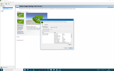

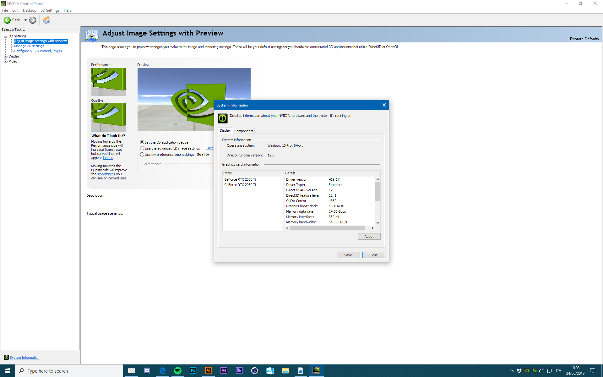

Please, go to Control Panel/Nvidia Control Panel, press the System Informations link, and share a screenshot, thanks:

I attach the scren
Btw, I reverted to the driver metioned from Aoktar in this Octane build version and deactivated the Denoiser in the viewport and till now seems no issue, I don't know if it's too early to speak…. :)
