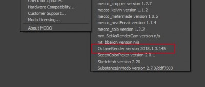

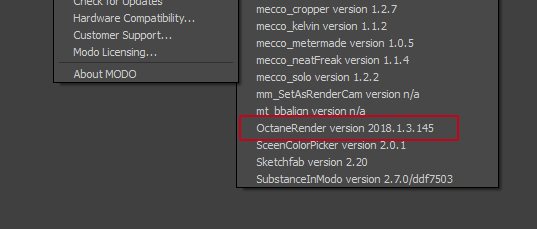

FYI modo shows the installed plugin as 2018 for v4 users with the latest build.
Dino Inglese
CG Artist
Melbourne Australia
Intel Core i7-4820K, 3x GTX 980ti
Windows 7 64bit, Modo 12.2v2 for PC
Octane build 4.04.0.145
face_off
Posts: 15760
Location: Adelaide, Australia
Thanks - I will fix this in the next release.
