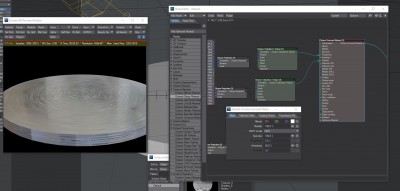

I'm trying to use anisotropy on a circular model.
The first render is made with anisotropy off, with a procedural on bump.
How to replicate this with anisotropy, without bump?

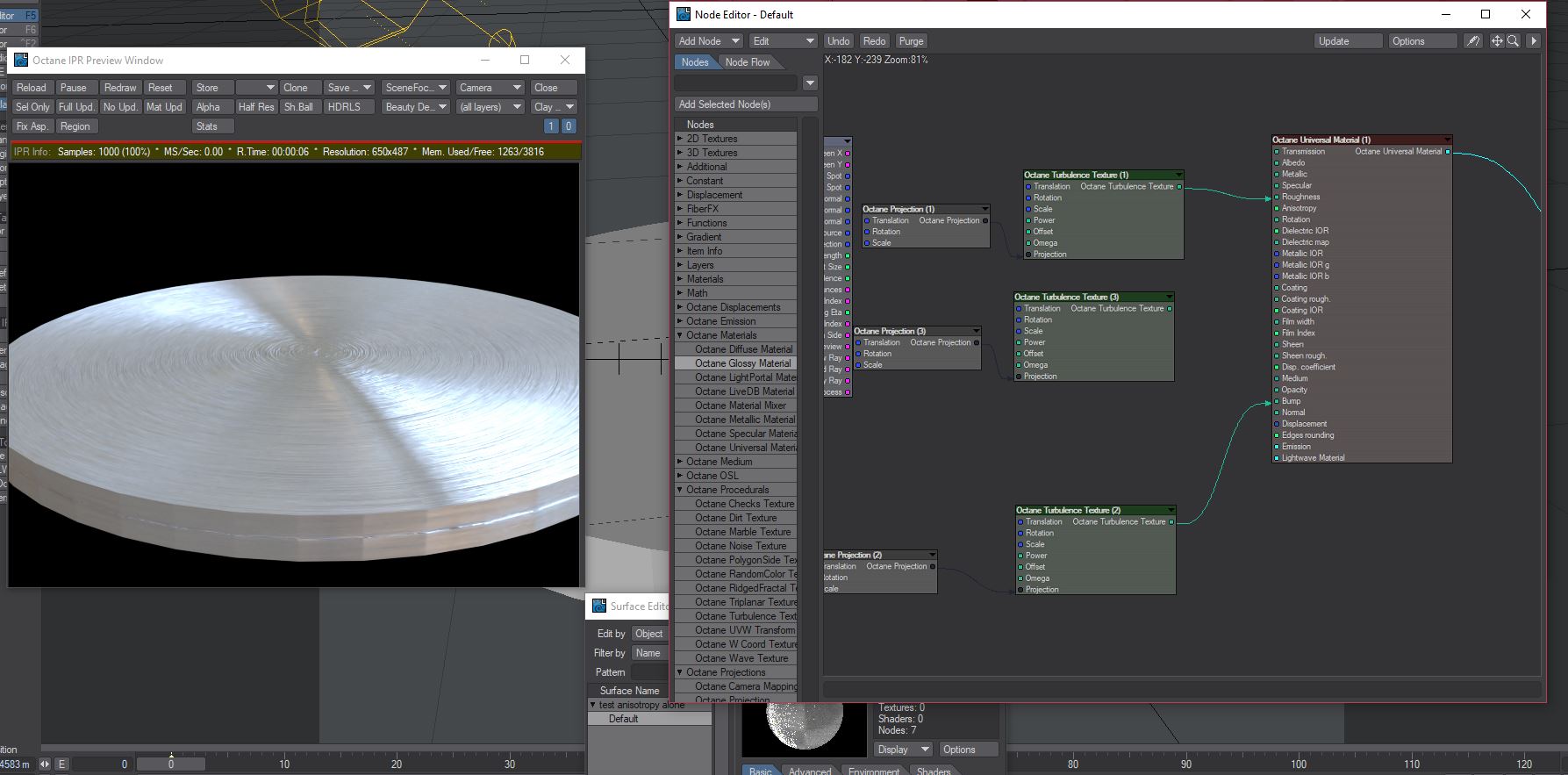

On the second image I use anisotropy with the same circular procedural on roughness and rotation. But it seams not working.
what am I doing wrong?
