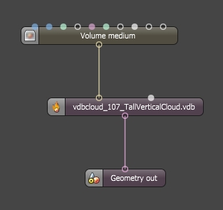

I used standalone to create an .orbx with a .vdb inside
VDB proxy.jpg (17.17 KiB) Viewed 2175 times
Then imported it in Modo using "proxy" with "live geometry" disabled
It's possible to "clone" the mesh that has the proxy loaded resulting in new mesh items, and it renders ok inside Octane. It's impossible to render "instanced" and "replicated" "proxys". Am I right?
Is there any workaround to enable the rendering of replicators using octane render?
As a side note: I noticed that when using this method nothing is displayed on the viewport. Although positioning the vdb proxy is possible using the mesh centre, it's impossible to have the size displayed. A workaround could be creating a mesh with the size and proportions of the vdb, and using it as reference for composing the image. Is there any other solution?
