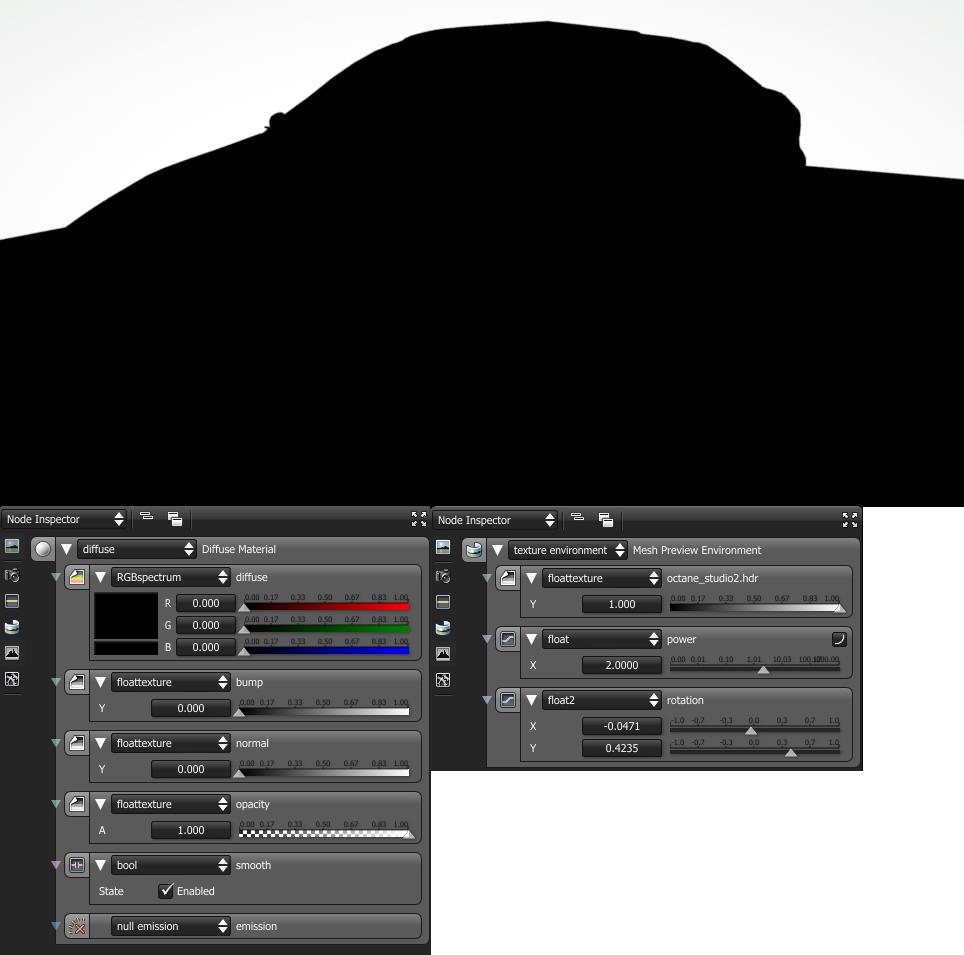

This is usualy (and better) done in post in almost every 3d app I know. Just render out your beauty-pass, render out an alpha-pass (in the case of Octane: all black model done with mateial settings and a pure white background) and comp your BG image over. This way you have absolute control over the final result.

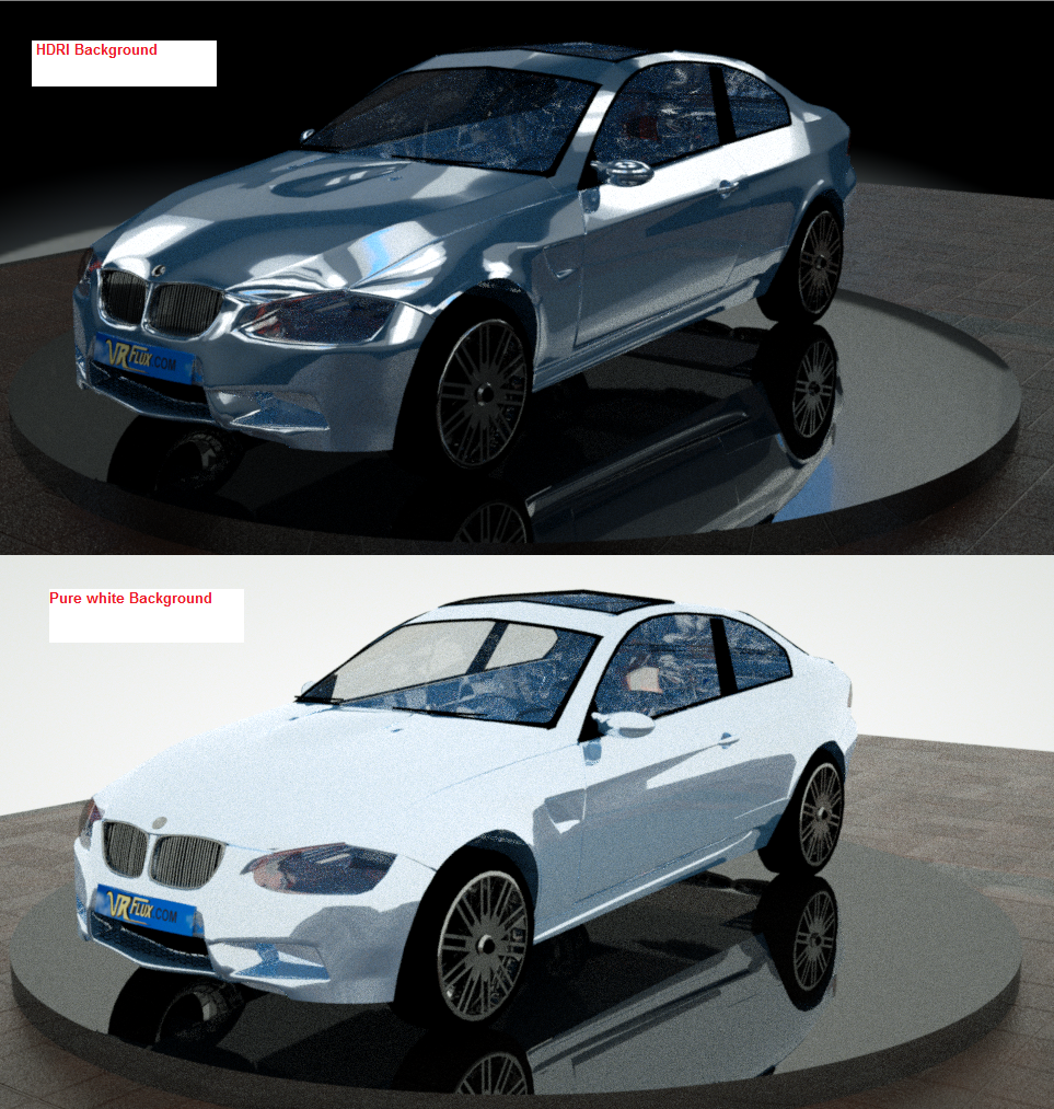

Thank you very much Lutze, but do you know if we can render an alpha pass in the pre Beta of Octane ? I don't find the functionality when saving a .png file. I only know that the final 1.0 will support alpha chanel.
I don't think that it works with a pure background as a texture environment because the white is reflected on the geometry. See example bellow :
HDRI versus White Background

He described how to make an alpha pass in his post - just set all the materials in your scene to pure black diffuse, and use a pure white HDR texture (e.g. floattexture turned way up). I've never done it but a lot of people seem to do it this way.

Yes, you have to render it twice as an alpha pass is not yet implemented in Octane. Therefor you have to build your own alpha pass by rendering the scene a second time with all materials set to pure black and the background to pure white. The lighting in your original beauty-pass has nothing to do with it whatsoever.

The disaventage of the technique is that you have to render twice, so it's right for stills but it's impracticable for animation.
