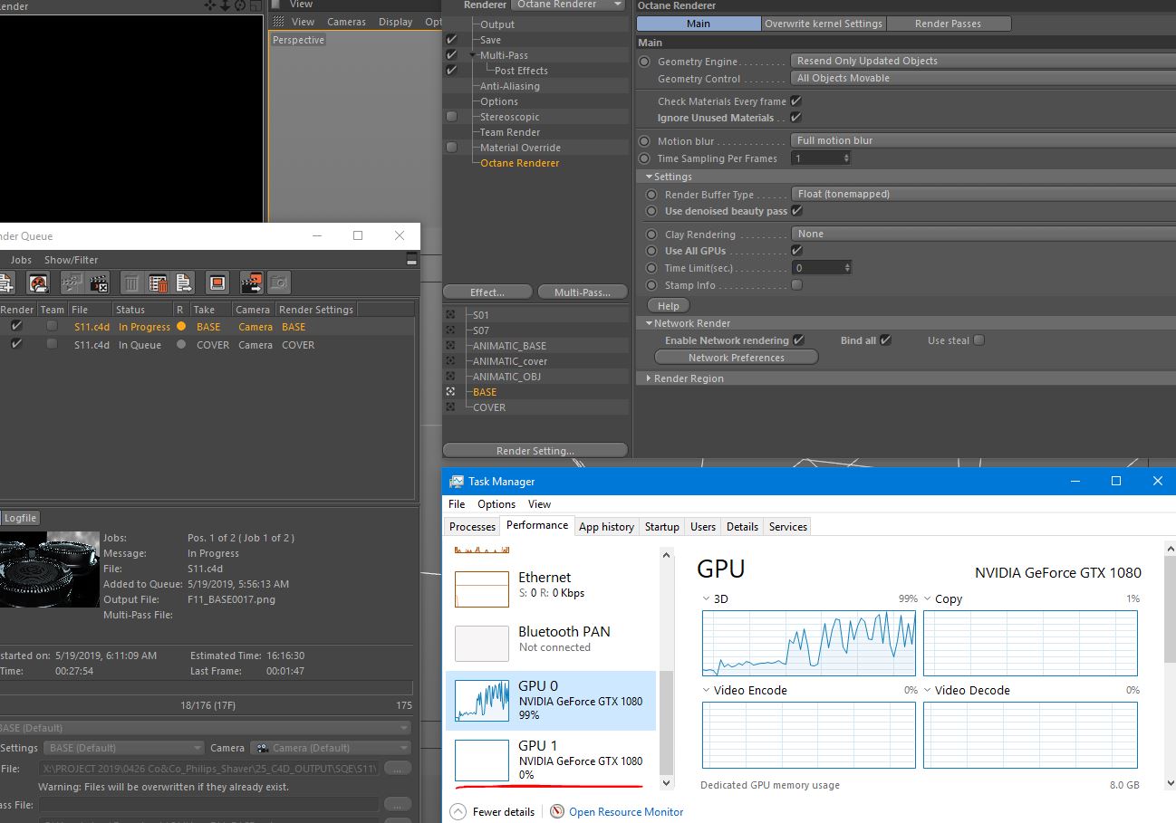

Task Manager show my 2nd gpu is not running, can anyone help?
I did turn off my SLI, and make sure I check "use all GPU"
Task Manager show my 2nd gpu is not running?
Be sure by doing render tests for selecting the one vs. two gpu on renders. You can compare render speed and times.
Thanks for replying Aoktar, sorry that I don't get what u mean.aoktar wrote:Be sure by doing render tests for selecting the one vs. two gpu on renders. You can compare render speed and times.
My 2nd GPU showed 0%, and 1st gpu is the only one running from 15% to 90%.
Hope anyone can help give me some idea how i can slove this problem. thanks in advance!
I mean be sure that's really not used by renderer. How do u know octane is not using second gpu? You can check gpu usage in render image. Check bottom line of render image for green gpu bars.
oh thanks Aoktar, I downloaded GPU-Z to check, an realize both GPUs are running.aoktar wrote:I mean be sure that's really not used by renderer. How do u know octane is not using second gpu? You can check gpu usage in render image. Check bottom line of render image for green gpu bars.
Just curious why task manager only show 1st gpu running, but not the 2nd gpu.
