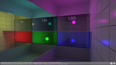

I made a quick test scene. - all lights are set to unseen by camera
- top row of lights (yellow, cyan, purple) are in front of the glass. Closer to the camera
- bottom row of lights (red, green, blue) are behind the glass. Further away from the camera.
-the amount of refraction on the glass does change the visibility of the reflected lights (top) but not the lights behind the glass (bottom)
- the middle pane of glass is set to iof=1.15

here's when I changed the left pane of glass IoR to 1.0001
the red light instantly becomes visible. Also the GPU ram used stats at the bottom change and actually go down while the CPU ram jumps up.CPU: Intel I9-14900KF | Mobo: Asrock Z790 Tachi | Ram: 128gb | Storage: 64tb | GPU: 2x Asus ROG Strix - RTX3090 24gb
