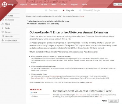

all You need to get is one of these: https://home.otoy.com/render/octane-render/purchase/
or if You already have v3/v4, simply choose upgrade and take Annual extension:
