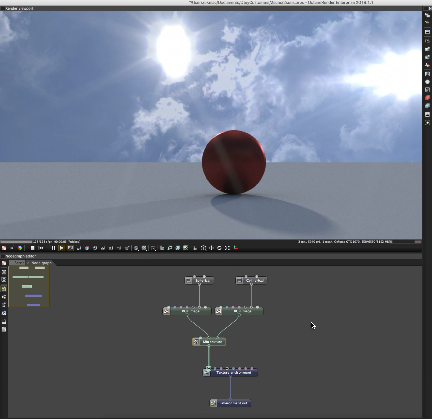

We need to create a scene with two suns. Anyway otoy can add multiple (2 or more) suns in the future?
Two suns?
One way would be to use daylight with an HDRI skymap with another sun. That way in your render you will see the Octane default Sun as well as the sun in the HDRI map. Just will need to re-position the HDRI skymap as needed.coilbook wrote:Hi,

Mutliple suns has been discussed, but first we plan to implement fast directional (distant area/point/spot) lights you can add through spectron in 2019.2+rajib wrote:One way would be to use daylight with an HDRI skymap with another sun. That way in your render you will see the Octane default Sun as well as the sun in the HDRI map. Just will need to re-position the HDRI skymap as needed.coilbook wrote:Hi,
