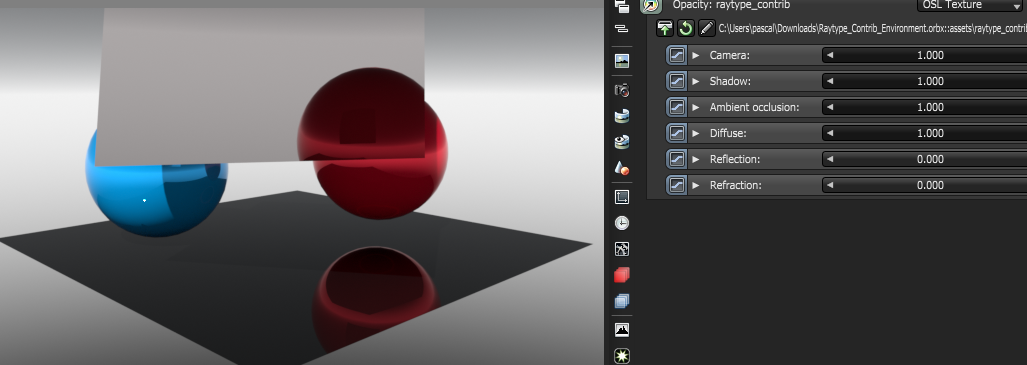

I don't see how to use max() function here,
but anyway addition seems to work just fine now and exactly as Simowlabrim expects :
blue sphere is not visible in reflection or refraction
Raytype_Contrib.orbx
(278.38 KiB) Downloaded 324 times

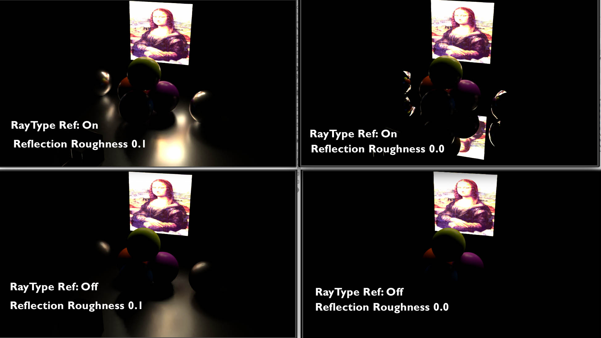

@calus, @milanm, I noticed that the Reflection raytype does not prevent the specular highlight when used with an emissive material like so:

Here's a simplified example of what I'm trying to correct/control. There's an emissive material visible in reflective surfaces. The Emissive material has raytype_contribution piped into the Opacity. Set the reflective surface material roughness to 0, and everything behaves as I would expect, with the OSL node controlling how the luminous object interacts with other lights and surfaces. Set the roughness of a reflective surface to anything positive, and you can see that the roughened/blurred aspect of the luminous surface's reflection still gets through. The only way to kill it is with the Camera rays.

@ Frankmi, thanks for the sample scene,
I found both shaders Raytype_Contrib and RaytypeBlend only work as expected if the Texture Emission's Sample Rate is set to 0 (this makes the light source indirect).
The problem is even more obvious with diffuse raytype ....
Indeed you were right looking for missing raytypes,
direct_diffuse rays and direct_reflection rays seem to be included in the camera raytype instead of in reflection and diffuse raytypes :(
I need to compare with other renderers to see if it's a an Octane bug or the way it is supposed to work.
