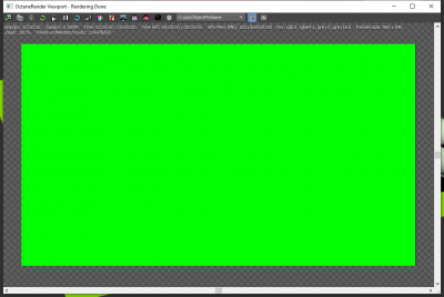

I am having the same problem. Octane 2018 in 3dsmax is just generating empty bright green data...... WFT

This is what I am getting as well

Ok figured it out and I cannot believe the answer.
You have to render a at MINIMUM number of samples which is equal to "bins" x "seed factor" for the cryptomatte data to show up and be valid.
So
rendered samples >= bins x seed factor.
If you are even 1 sample below it does not work.
For example if you want 4 bins of 15 samples per bin you have to render at least 60 samples for it to work.
