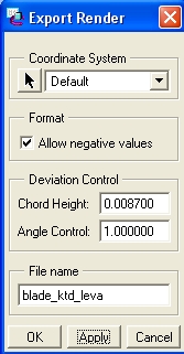

Here you can find my export setup. Note: this is an old pro/e version, the real job has to be done on wildfire5. Dunno if it matters.

Dont know if you can play with tolerance and deviation in real time but:
if I (have time and) need tests
maybe I use higher to lower tolerance (chord height) - say by step like 1, 0.8, 0.6, 0.4... (or any other)
with deviation angle constant from lower to higher - say 0, 0.1, 0.2, ...
Lower tolerance or deviation = more triangles but for such objetcs you need high tesselation.
I'm not sure it's something regarding pro/e export.
For other purpose (3d print) we have to export .stl file that has a similar export interface and using the min allow value for chord and 1 for angle give very good result. I know it's not the same but looking for other idea I found this: http://blenderartists.org/forum/archive ... 91765.html.

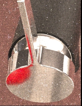

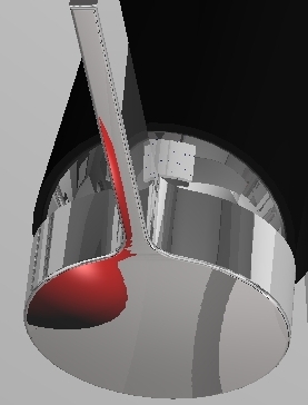

I did other tests and I'm getting more and more confusing.
Here is a the result of the Blender internal renderer compared to the Luxrender one. Sorry for the low quality of the Lux render but I've got no time to go on further (+1 to Octane
Nothing has been changed into the geometry/meshing.
Sure, Luxrender use different materials setup but it has no 'smooth' option to mark.
Why the reflection is different ? One is curved, the other is straight (as it has to be). I would expected Luxrender to be curved...
Is this someway linked to Octane result ?
I even don't know if this is still the right place where to ask this questions. Please let me know if I can continue.
Thanks.
