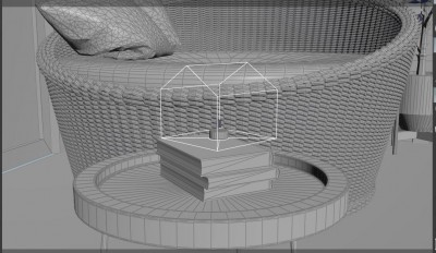

Ok. I have a clue about the problem. In your object, there are some polygons that share the latest vertex (to render them as a wireframe mesh? I don't know), so they have more vertices than points. You can see these polygons as a wireframe in the attached image.
These kinds of polygons are not supported by the plugin and in fact, they are breaking the whole object extraction. Probably if you remove these polygons all should work fine, but I'll try to add a filter to the plugin to remove them automatically.

oh cool! that really works, thanx juanjgon, so simple, i even didnt think that those edges without polygons could brake whole geometry, good to know =) thanks!
