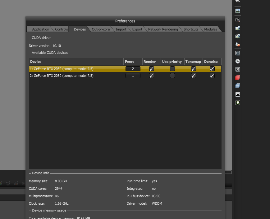

I have R19 and Enterprise license. Win 10 64bit and 2x2080 RTX connected via NVLINK.
I created a quite heavy scene in C4D but the NVLINK doesn't seem to be triggered.
I exported the scene to the standalone and there the NVLINK is working with p2p statistics.
Since in the standalone you have to select the peer in settings window... I was wondering if there's something similar in the C4D plugin.

Literally the same exact question here. Do I enable something? I've done all the right steps but it's not working.

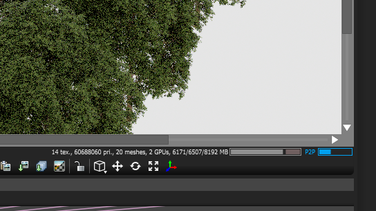

How do you know that's not working?

Cause after a certain amount of trees (I used trees to fill the vram quickly) it goes in OUT OF CORE. With that amount of trees the standalone goes on NVLINK peer.

I mean this
