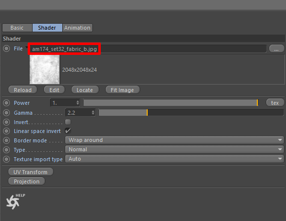

Actually i believe i have solved this issue. when i check the logs i can see octane cannot find texture assets for the materials that are taking long to generate.
but when i look in Cinema4Ds texture manager all textures are located in tex folder as i would expect, since i saved project with all assets.
even when looking in the materials with missing textures, the image texture node shows the expected path (in \tex), but when i try and locate the texture through the image texture node it points to the old texture location before the collect.
so after deleting the image texture node with the broken path and replacing it with one that links to the \tex folder this issue is fixed.

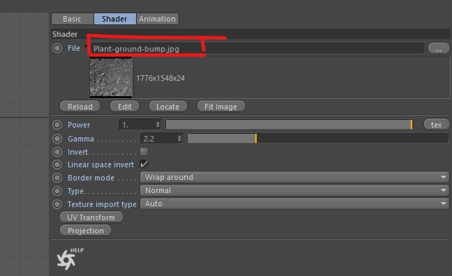

yes some of the paths can point to folders with maybe 50 textures in them. also i have updated to 4.04.
I guess what im still trying to figure out is why when i saved the project with assets some of the texture paths were correctly rewritten and some were not.
when i look in both the Cinema4D texture manager and the Octane texture manager it shows all the textures in the new collected location (\tex folder) but octane still looks for some of the assets in the old location.
you can see in the screenshot above the image texture node seems like its looking in the right place, but when you click the locate button its shows the old path where the texture was before the assets were collected.

as i have said both the C4D texture manager and the Octane texture manager both point the expected location after a collect; which is \tex (this is the location where the assets are, and where i want them).niestudio wrote:Have you looked at the octane texture manager? Once in there you can find/replace old paths with new ones.
for some reason octane is still looking for the assets in old location.

just wanted to update in case anyone else come across this issue.
I realize now the reason the material generation was slow is due to a network issue not related to octane or C4D. My workstation was recently moved to a new switch which likely has created an unreliable connection to networked drives.
but this was odd since i collected all assets for this project onto a local drive using Cinema4D's "Save Project with Assets..." so Octane shouldn't be looking on networked drives at all.
when i check the log i can see some texture assets are unable to be loaded (do to the aforementioned switch), but the path its using is the old networked path of the original asset; not the new \tex path
when looking at Octanes texture manager and in the image texture node you can see its pointing to the new \tex path but octane still searches for the asset in the old path, pre "Save Project with Assets..."
