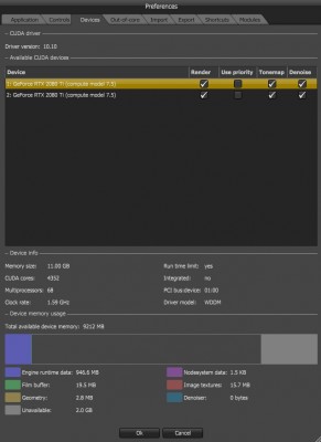

Hi guys!
downlaoded and installed to play a bit with new features.
is it normal that I don't find any RTX control in this release, differently to what mentioned in main topic?
I attach a screenshot.
Thanks!

Hi guys!
Thanks!

You must be using a different version as otherwise you'd see something different there. Please make sure you download one of the links from the initial post from this thread which are the only ones that currently support this feature.shine71 wrote:"Q: How do I know my GPU is using hardware for ray tracing acceleration?
A: Make sure RTX acceleration is enabled in File > Preferences > Devices Tab > Use RTX acceleration (experimental). RTX acceleration will be enabled automatically for all devices which support RTX hardware acceleration, currently the NVidia Turing GPU range. "

Thanks a lot for your reply, Mojave!
I'll be trying asap!
Have a great day

@Eklein Thank you for you reply! Im not home yet but will try this today right away:Deklein wrote:marcvankaam,
I had the same problem with my 2x RTX 2070 their was no difference with "RTX On". The problem is the Nvidia driver 419.35. Download the new version of creator ready driver 419.67 that Nvidia did for GDC. Is not available yet in the normal nvidia driver location. Get the Windows version from here https://www.nvidia.com/content/DriverDo ... type=TITAN.
See below the test with 2x RTX 2070 with benchmark scene where I got 3.16 times faster with "RTX On" and 70.08 M/sec.
