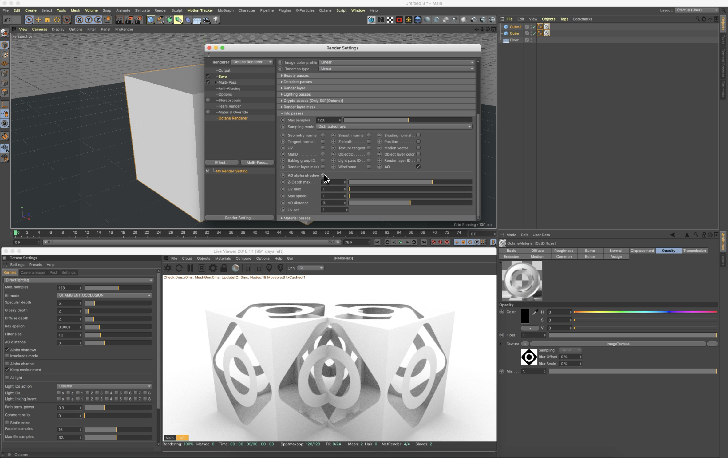

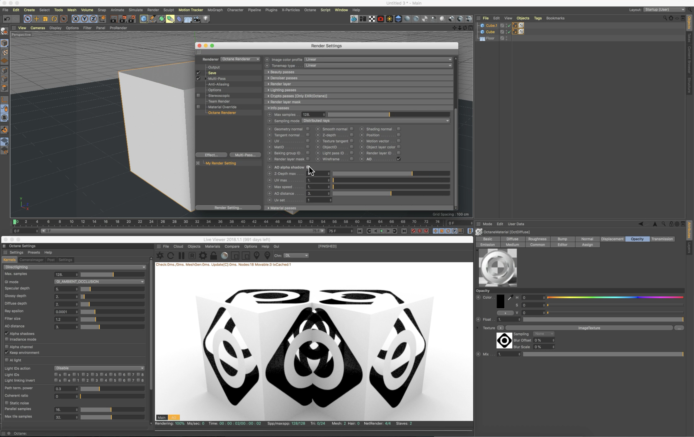

Alpha shadow option is necessary to handle transparency and opacity textures, but costs rendering power.
The option you mentioned is relative to the Ambient Occasion pass in the Info Passes group.
Here is with the option disabled:
And with the option enabled:
