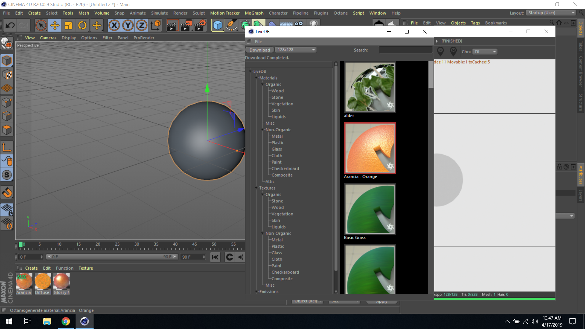

I was using the octane materials (and GSG Everyday material for octane) for a while and they were working fine.
Today many materials i am loading are either not loading or loading as 3 materials not one.
attaching an example. i tried to load "orange" material but instead i got 3 material.
any idea how to fix this? thank you
Posts: 10575
always download LiveDB materials in an already saved scene, otherwise the plugin doesn’t know where to save the associated textures.
When you have three materials instead of one, it means that the downloaded material is a Mix Material.
Use the material with the green MIX text on the material preview.
ciao Beppe
Alexisbaydoun
Posts: 44
Joined: Tue Jan 29, 2019 2:03 pm
Thank you! it seems to have worked now..
