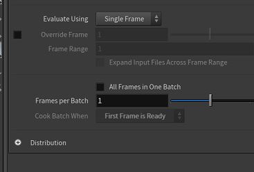

Using new Tops context, how to you tell houdini to launch one frame after each other.
Actually my tree try to render different wedge at the same time.
juanjgon
Posts: 8867
Location: Spain
Have you tried to configure the ropfetch top evaluating using single frame and with 1 frame per batch?
2019-04-04 23_32_18-win64-workstation - TeamViewer.jpg (9.62 KiB) Viewed 2524 times

yep :-/

Looks like the local scheduler node is the way to go.

Ah, Great! Thanks for the information. I was not sure about all these new TOPs stuff works and how to execute the process one by one using a single process.

the thing is it's not perfect because this is affecting the complete chain.
In case of complexe network could be cool to tweak this node by node and not the complete network.
More a sidefx problem than Octane Plugin anyway.
