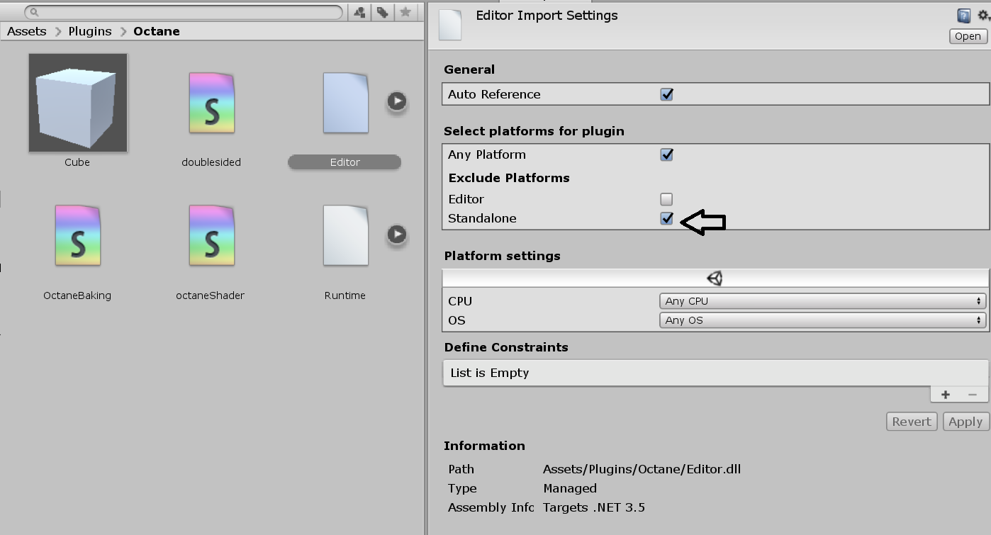

So ive recently been developing in unity 2018.3.9f1 and have been using octanes PBR lightmapper. All is well and im getting good results.. however i needed to build my scene for testing but when i come to build my scene (PC) i get the error below.
I've searched the internet and no idea for a solution. I can build my scene at the minute which is a huge set back. Do any of you guys have any idea what could be causing this.
ArgumentException: The Assembly UnityEditor is referenced by Editor ('Assets/Plugins/Octane/Editor.dll'). But the dll is not allowed to be included or could not be found.
UnityEditor.AssemblyHelper.AddReferencedAssembliesRecurse (System.String assemblyPath, System.Collections.Generic.List`1[T] alreadyFoundAssemblies, System.String[] allAssemblyPaths, System.String[] foldersToSearch, System.Collections.Generic.Dictionary`2[TKey,TValue] cache, UnityEditor.BuildTarget target) (at C:/buildslave/unity/build/Editor/Mono/AssemblyHelper.cs:150)
UnityEditor.AssemblyHelper.FindAssembliesReferencedBy (System.String[] paths, System.String[] foldersToSearch, UnityEditor.BuildTarget target) (at C:/buildslave/unity/build/Editor/Mono/AssemblyHelper.cs:190)

The most likely cause is that you need to exclude the editor.dll from standalone. (Octane/Runtime.dll should not be excluded from standalone)
Let me know if this dosnt help.
Ill check if it possible to have it excluded by default in future versions.

Hi Chris,
Thankyou so much that seemed to do the trick!
