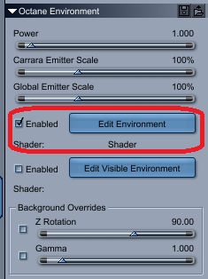

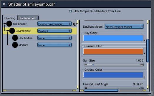

If you are using Octane 4 then you need to create an Octane Environment and set the environment type to daylight. From there you can set the sky and ground colors. You cannot change the color of the sun itself.
Octane Environment
Octane Environment
Daylight Settings
Daylight Settings
