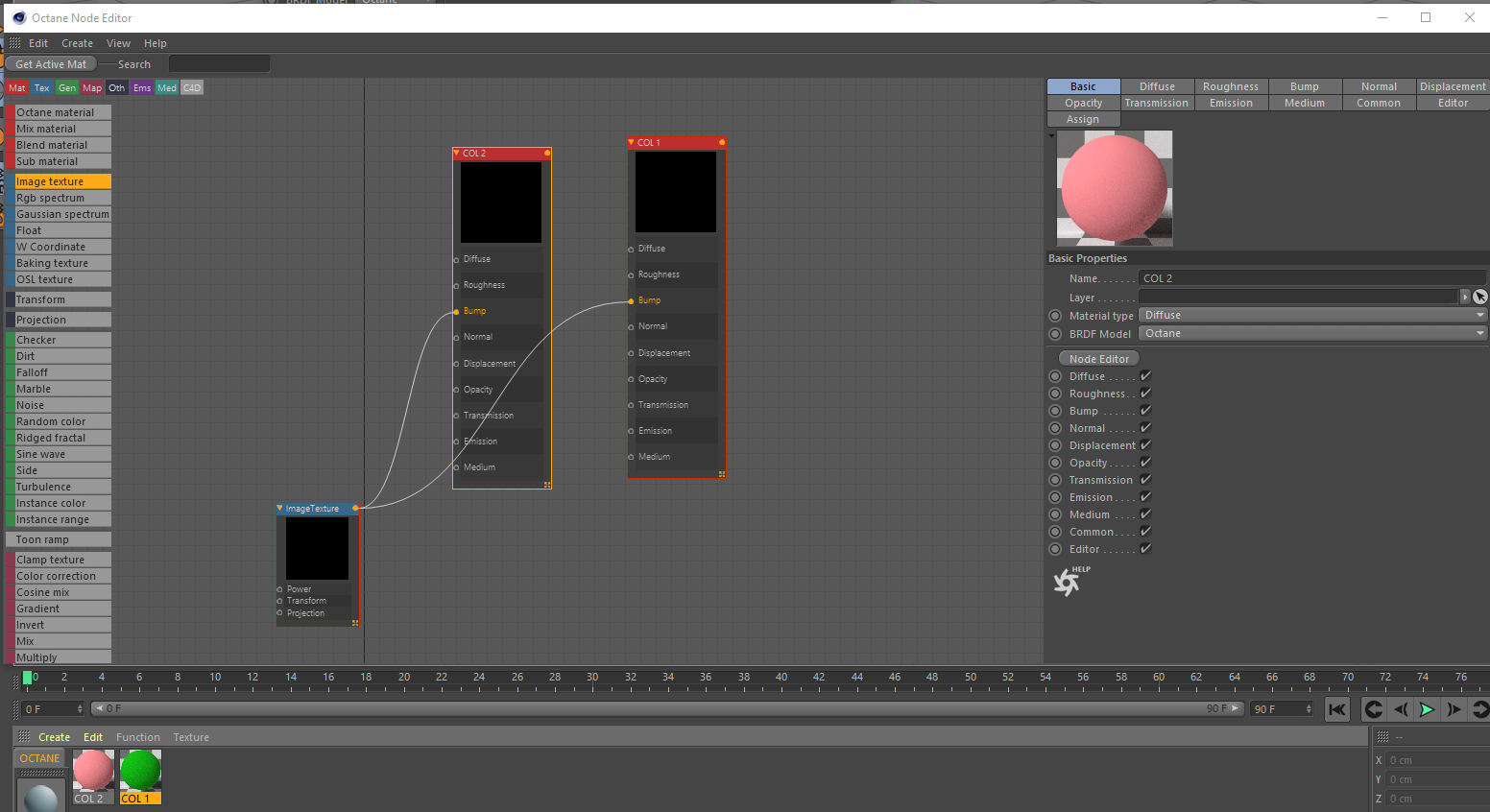

I think if you create a material and open the node editor, plug in the textures and change diffuse col, then drag in another material, so you have two laid out in node view then plug in the textures
