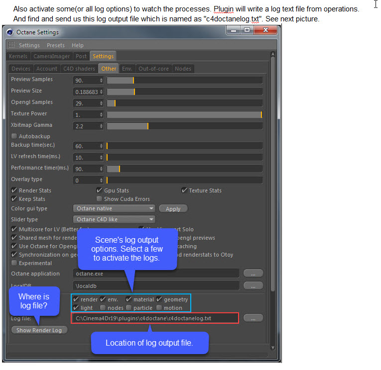

I don't have much idea what's up! But activate all LOG OUTPUT options as in the picture and try to reproduce the crash. And send c4doctanelog.txt here.

I've attached it.
I was having problems with the scrolling on my tablet, so I thought it may have been something along those lines? I fixed my tablet though so I don't think that would be it?
c4doctanelog.txt
(1.16 KiB) Downloaded 156 times
