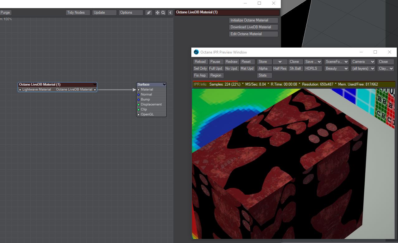

juanjgon
Posts: 8867
Location: Spain
What plugin version are you using? I'm testing your material here with the latest build and it seems to work fine. If you get a crash with it, I'm going to need an example scene to try to reproduce the problem here.

2019-04-01 23_09_06-Layout™ NewTek LightWave 3D® 2019.0 (Win64) - multiple_uvs.lws.jpg
joseburgos
Posts: 30
Joined: Sun Jan 21, 2018 2:21 am
So yes if I add this texture to a simple cube, it does work so it is not the material.
