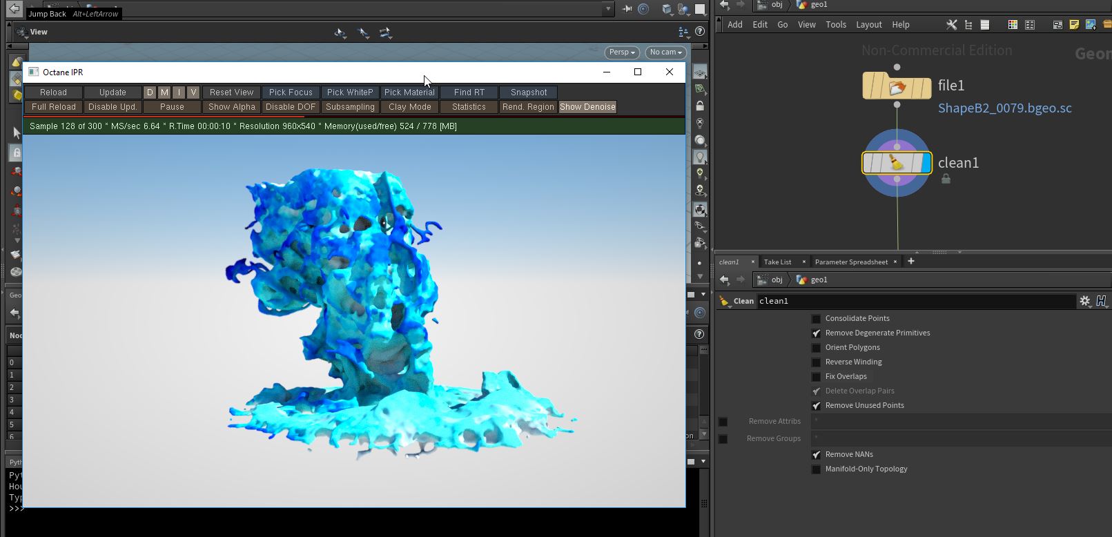

Hi all,
I 've a problem with a baked surface generated with "Particle Fluid Surface" SOP. I've to render the point color of that surface, but in some baked frames, otoy cause the crash of Houdini (without save the temp file).
I use Houdini FX Version 17.0.506 (indie) with Octane_2018.1.0.6_Houdini_Win64_vr.
In this link you can download a simple frame of my simulation.
https://drive.google.com/open?id=1nG6-k ... k317vGTslH
Thank you all, any advice will be great!
Paolo

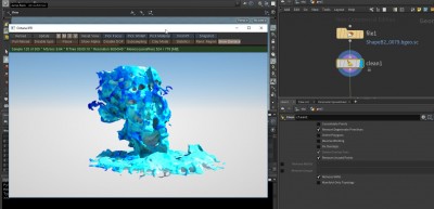

It seems that this object has some kind of degenerated geometry. Can you please add the Clean SOP and try again? As you can see in the attached image, once added to remove the degenerated geo, the rendering seems fine.
Thanks,
-Juanjo
Luther76
Posts: 26
Joined: Fri Mar 24, 2017 3:49 pm
Hi Juanjo,
It works!!!! It was so easy.... I was going crazy.
Thank you so much!
Paolo
