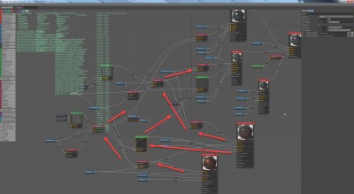

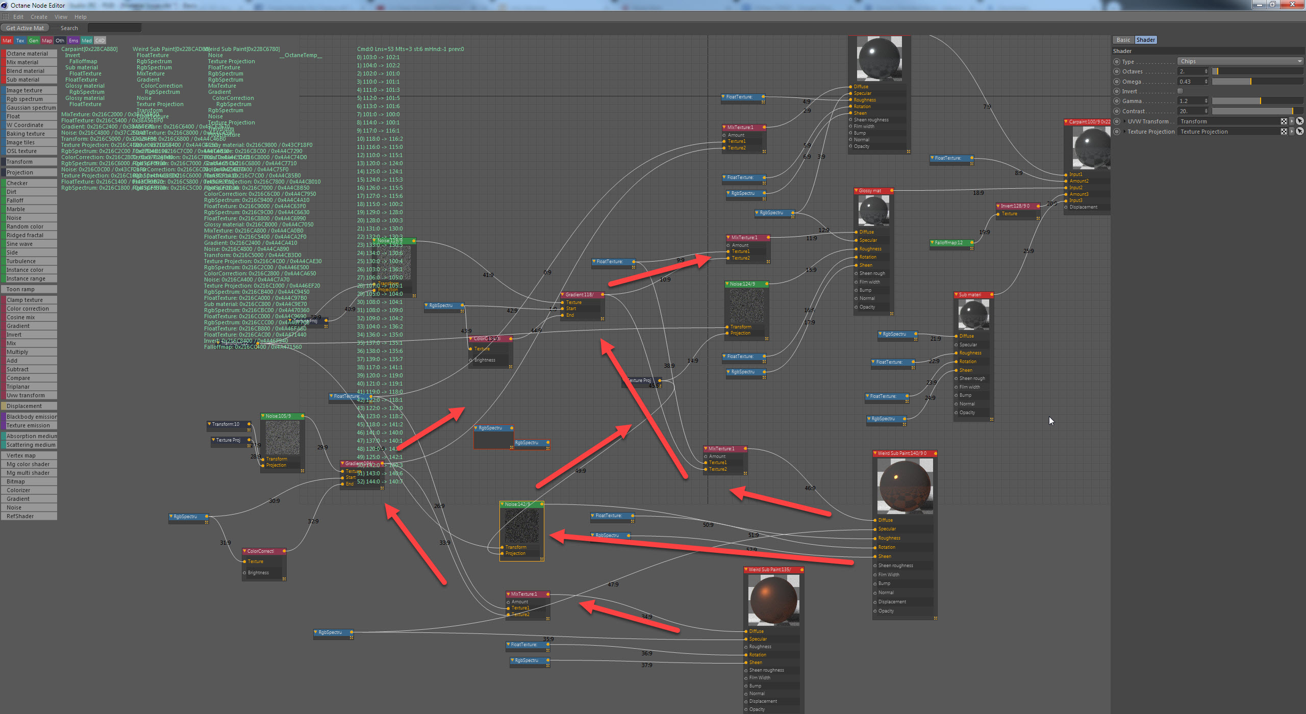

Thanks! I'm looking into but you're having some nodes in BLEND material. They are owned by different materials. See IMAGE. So they will be lost if you delete OTHER materials. How could you CREATE these nodes and ADD to BLEND material?
