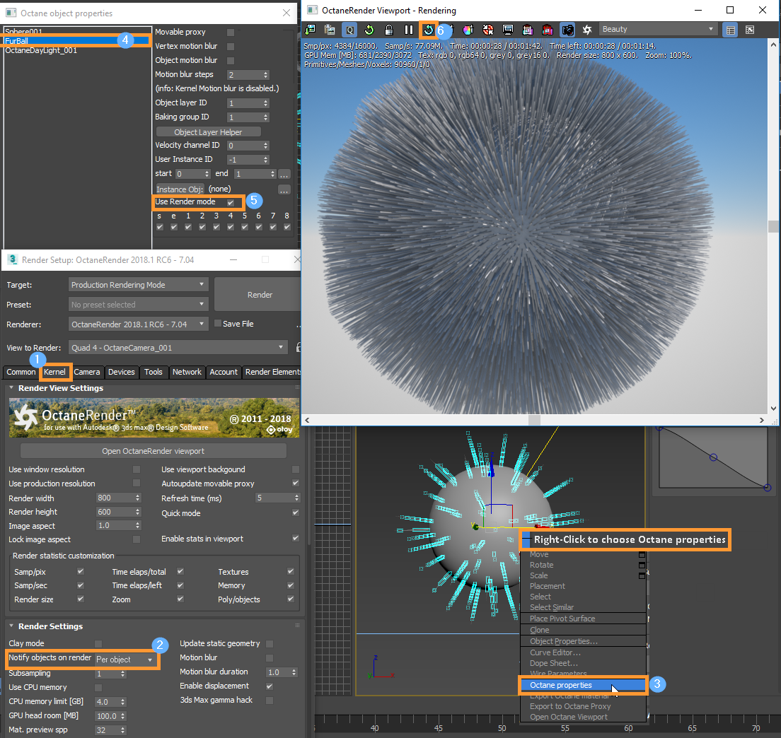

Fixed =) Thank you for Bikram from support team =)
So, to render OX Hair in Octane with 1% hair in viewport - you should do this steps.
- Change the "Notify objects on render" as Per Object or All Object from the Kernel tab.
- Right-click on the viewport and choose "Octane properties"
- Check/Enable the Use Render mode
- Rebuild the scene button to use the scene in Render mode.
