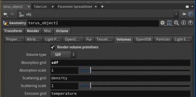

How do you render volume SDFs in Houdini? I can't seem to figure it out.
Also, any basic guideline on how to use the vectron option. I says pick OSL geo SOP but what do I pick.
Example files would be most helpful. :)

You have a vectron example scene in the 2018.1 release post:
viewtopic.php?f=102&t=71022&start=1
About the SDF volume rendering, you only need to select this volume type in the Octane OBJ spare parameters, but of course, you need a volume with an SDF type grid.

Thanks. It works. :)
And I totally missed the vectron file in the 2018.1 release post.
