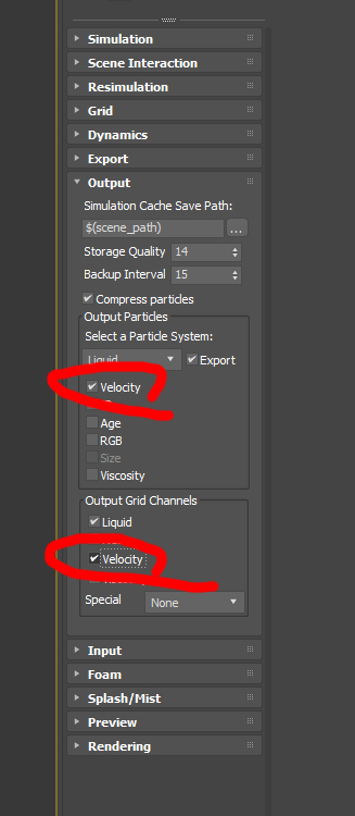

for the MB make sure you output velocity
