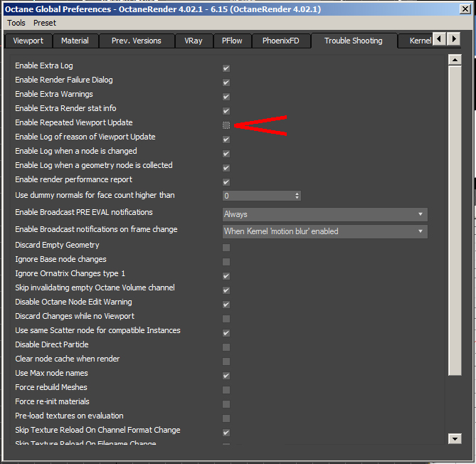

As far as I know, my settings are either the default, or whatever some Otoy representative told me to set because I posted about the Max viewport being very slow. That setting says: "...but this will likely increase render time or prevent rendering normal update." So why would I want to enable that?paride4331 wrote:senorpablo wrote:Not in v4.02.1 - 6.15.paride4331 wrote:Hi senorpablo,

Why is it always such a battle to get a bug fixed with you guys? I shouldn't have to manage secret, obscure settings, for a reload button to work properly. A reload button should "just work."
