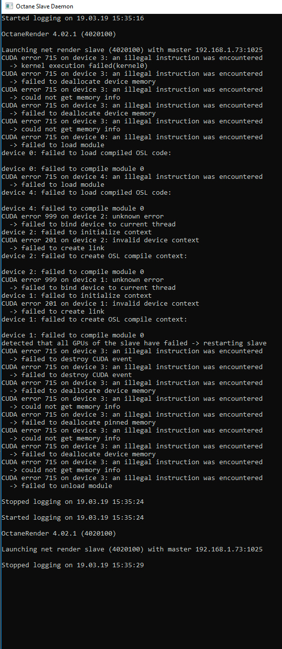

I've got that major problem (see attached) on my slave PC. Just done the 4.02.1 octane update and Cuda update on the PC.
The main machine is a Mac with Cuda 410.310 (doesn't work with the last one).
This problem happened just by clicking the render button with no model in the scene.
HELP

And just tried Octane 4.02.1 in C4D on the PC with plugin, i've got the same error.
Did the last Cuda update works well with last octane stable version ?

try to install the following GPU drivers:
https://www.nvidia.com/download/driverR ... 2147/en-us
If not enough, please go to Apple menu, About this Mac, then press the System Report button, then go to menu File/Save, and share the resulting .spx file, thanks.
