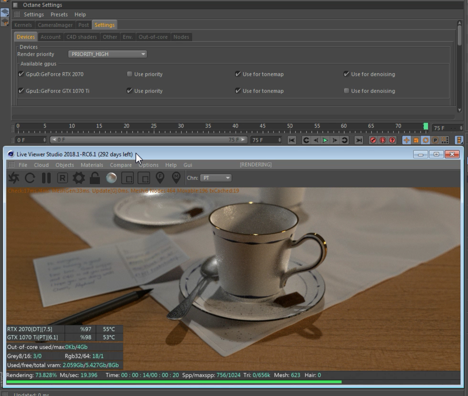

So since Standalone RC6 and presumably final version is back to 2 GPU rendering, is RC6 plugin allowing more than a single GPU? I can't enable my second GPU, no errors, I can set it, but then it just unselects itself. Any idea on when final version is coming and will it support 2 gpus?

bepeg4d wrote:Hi,
c4doctane 2018.1-RC6 Studio already supports 2x GPUs:
ciao Beppe
*sigh*
Don't mind me. I'll go be dumb somewhere else. I made a mistake in which plugin I currently had installed. Thanks!

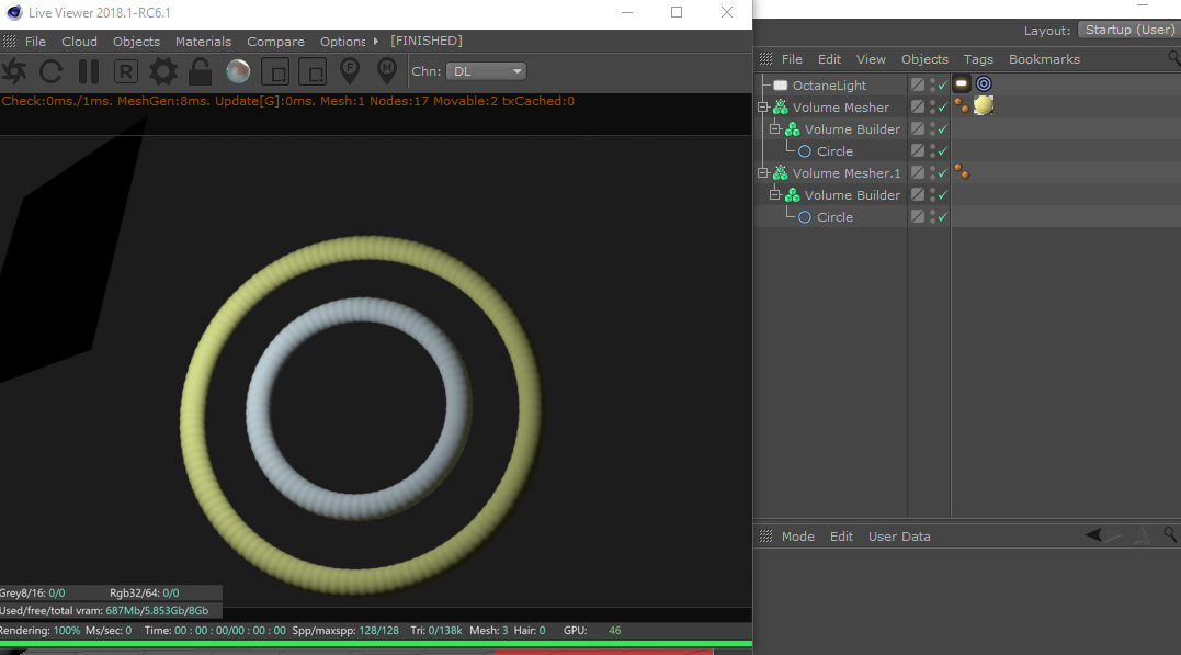

This version not work with cinema Volume builder. I start render and nothing happens. VDB Volume object does not work same.

divasoft wrote:This version not work with cinema Volume builder. I start render and nothing happens. VDB Volume object does not work same.
all ok
all ok
No, you don't understand me. Why did you use Volime mesher? I talked about Volume Builder only and vdb loader. Try it
