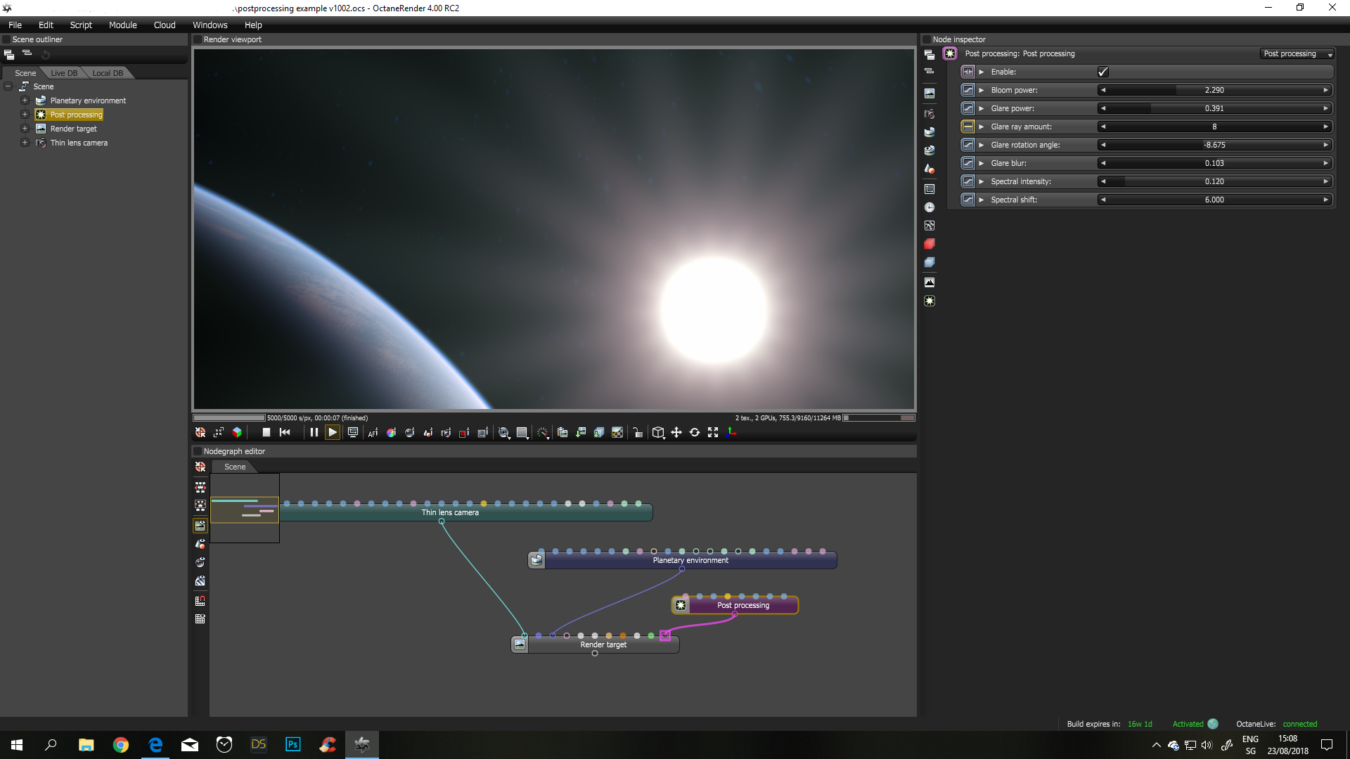

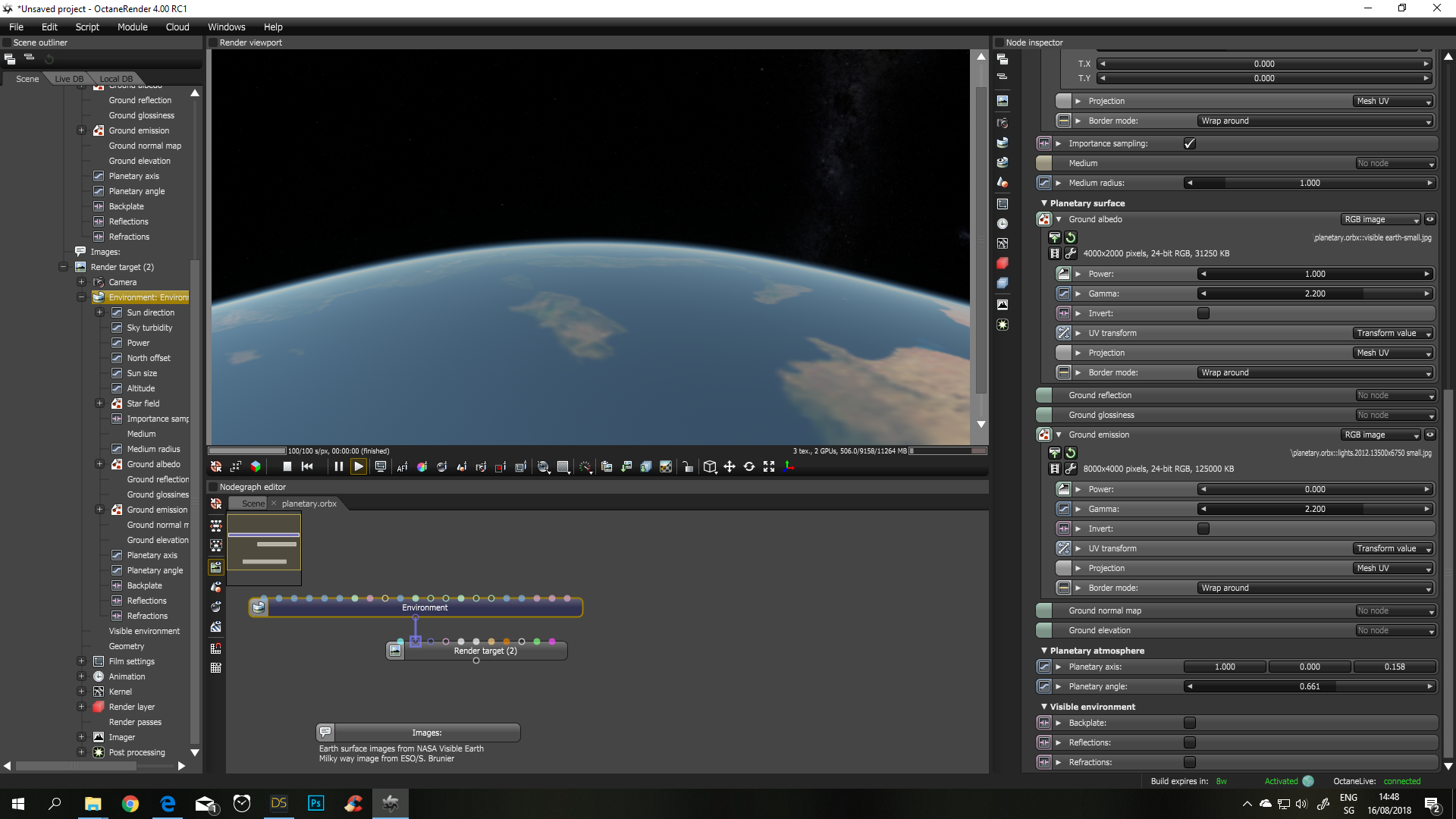

Default scene:
Some examples of adjusting parameters to yield different effects:
- Use the Sun Direction to change the position of the sun
- Change Post Processing settings to affect the look of the sun
- Ground Albedo is visible during day
- Ground emission is visible during night
In the above images the Panoramic camera with Projection Spherical (equirectangular) is used.

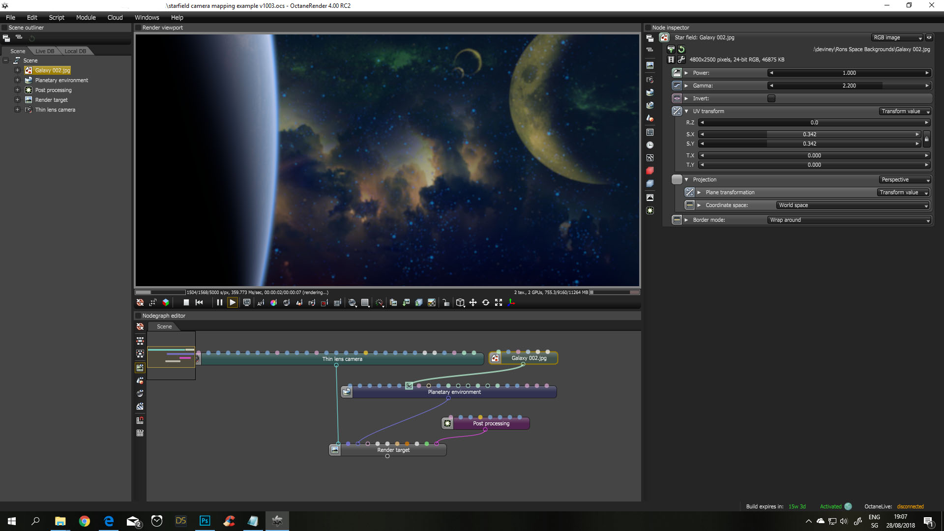

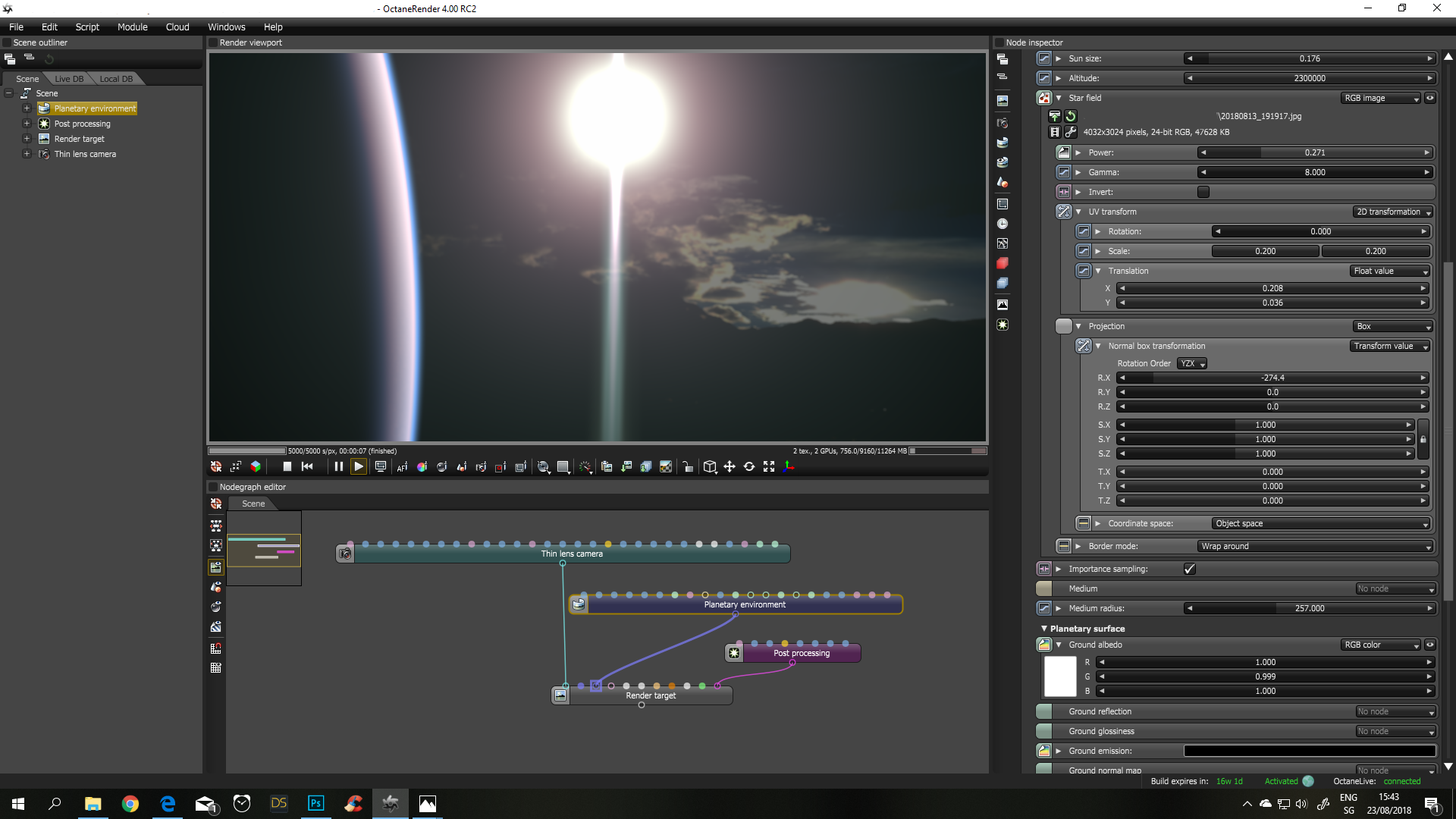

Examples with the thin lens camera:
- Adjust the Power of the Star field map
Planetary Environment & Starfields - Examples

The goal of this example is to have the starfield as "background" image fit the screen exactly.
A special thank you for roeland who had released a camera mapping script here:
viewtopic.php?f=73&t=37574&p=344873#p165233
While setting up the planetary environment you may have to change the "Up-vector" of the camera.
This means any texture applied as starfield will now probably also look in another direction.
With the help of the camera mapping script by roeland it is possible to match the image settings to the camera.
When the script is applied the image orientation now matches the camera:
All that is left is to adjust the UV transform Scale parameters so the starfield image matches the viewport:
