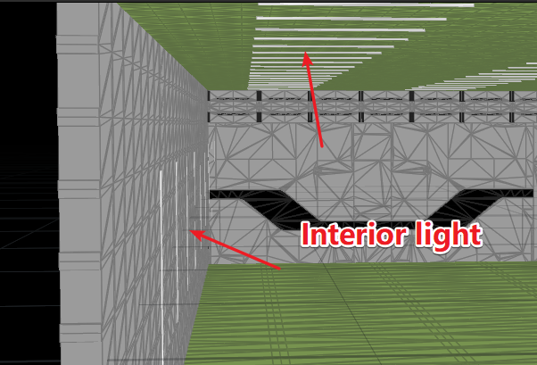

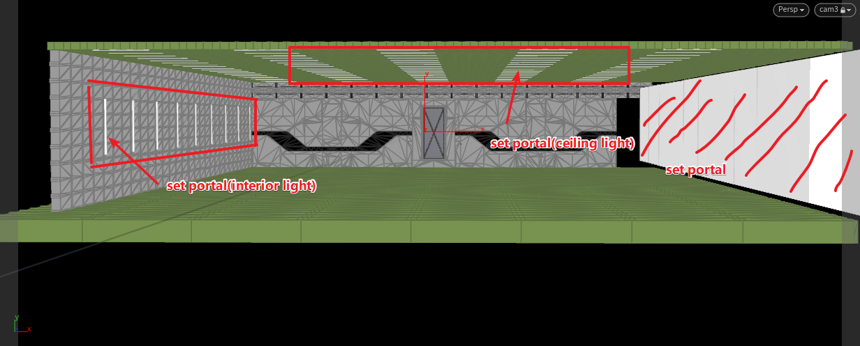

I have a troble with rendering interior scene.
I set all of interior light as portal material, but It doesn't work correctly.
Greetings,
Edsion

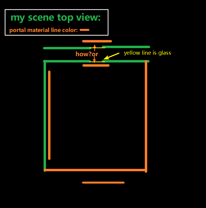

hello,
your meaning is every windowns need to be covered by portal geometry?
how to arrange my portal in my scene?(see the picture)

Hmm, the main problem can be that you can't have a glass object in the window. The portal lights only work on open holes, so they should not be blocked by other geometry such as a glass surface.
You should start with a simple scene (for example a box room with only one window) to see if you can make the portal light work, to later try to configure your complex scene, but in any case if you want to send me an example scene with your lighting setup I could take a look at it here.
Thanks,
-Juanjo
roeland
Posts: 1826
You can have glass but it must have the fake shadow option enabled.
Portals do not have an effect if your entire room is surrounded by portal geometry. It has effect only if light from the environment is coming in from a small amount of windows, these windows should then be covered with portal geometry.

Thanks for your answers,
I had tested the portal light setting. whether in this or test scenes.,It's worked. I see the boundary at the location of portal light , I think I need to incease my sample to decrease noise...
Best regards,
Edison.
