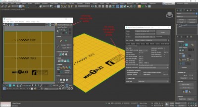

1) You can control preview resolution of Octane's map in Kernel tab - Mat. Preview W/H
2) You can select octane's maps in Unwrap UVW

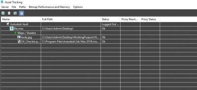

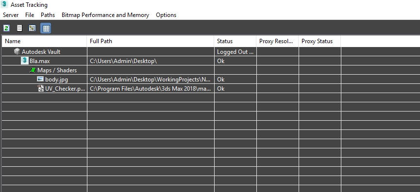

3) You can see and reassign all paths for octane maps/vdb/proxy etc in Asset Tracking utility (File - Reference - Asset Tracking Toggle)
I've attached couple screenshots
Cheers

I never use the asset tracker so I never though to try that rather than the bitmap/photometric paths editor. I'll try to remember that in the future, thanks.
