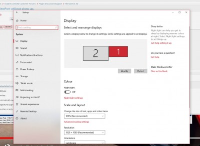

Go into this screen in your computer settings and muck around with the position of your two screens. It will pop up. I just spent hours trying to work this out.
