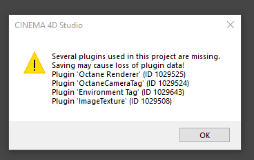

Hi, I am on Windows, c4d r20, nvidia 419.35 and tried Octane 4.02.1-R4 & 2018.1-RC6.1. When I start C4D, Octane plugin can't be found. I installed it the way I always install Plugins and Octane.

No need to post in the bug forum. You missed matching the minimum requirements. R4 needs R20.057 or later. Btw I've removed R4 build due some problems, try R3 build.
