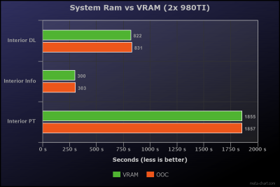

Because i couldn't find a clear answer on the forum, i ran some benchmarks to have some numbers.

But i cannot go on those comments, i need numbers. I build machines for people who use Octane (or other), and i must have precise answers. So i made a small test bench today.
Here are the results
Machine :
i7 8700k
2x 980TI
1x 8gb of DDR4 (PC4-24000) (so yes, running in single channel, so pretty much a worse-case scenario )
Octane Standalone Demo 4.02
Test :
* Downloaded Octane Standalone Demo (https://home.otoy.com/render/octane-render/demo/)
* Downloaded Benchmark Files (https://render.otoy.com/octanebench/ at the bottom)
Opened Scene file, and didn't change any settings.
I choose the "Interior" scene as it's in my opinion the heaviest scene.
Results:
Data:
Code: Select all
Interior DL
VRAM : 13m42
OOC : 13m51
Interior Info
VRAM : 05m00
OOC: 05m03
Interior PT
VRAM : 30m55
OOC: 30m57
