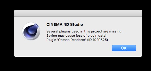

I added the updated plugin to the R20 plugin folder just like i've done the past 3 years, and C4D does not see the plugin.
Is this just me?
4.02.1-r4
C4D R20.030
UPDATE: Updating to 20.057 fixed issue.

Posts: 16063
Location: Türkiye
natemac00 wrote:I added the updated plugin to the R20 plugin folder just like i've done the past 3 years, and C4D does not see the plugin.
Is this just me?
4.02.1-r4
C4D R20.030
You need minimum R20.057 for R20. It's noted in requirements.
