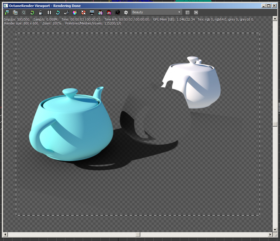

Hi guys,
i think there are some bugs with the matte shadow or shadow catcher?
everything object can be a matte shadow or just an object plane ?
paride4331
Posts: 3986
Hi stephen00,
yes you can, it works.
Regards
Paride
jim99
Posts: 74
Joined: Wed Aug 19, 2015 6:07 am
How do you create a invisible matte shadow object? like the middle teapot.
I have tried layer id but unable to do the same you did there can you share the settings thx
Jimmy
paride4331
Posts: 3986
Hi jim99,
shadow catcher option is in universal and diffuse material.
Regards
Paride
